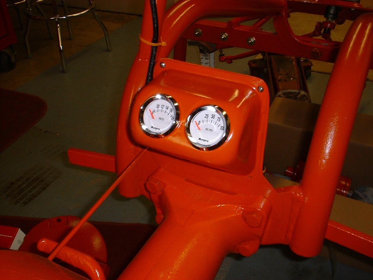

I made a new fuel line and located a newer style fuel shut off valve right near the Carburetor so it was easy to get to to make for the flow shut.  LOL! Also put a little inline filter next to it to. I'm for easy. Who the heck's design was that to put the shutoff under the tank to make it difficult to get to. Even with me being built close to the ground was a pain. It was probably the same engineer that put the oil pressure gauge and Ammeter gauge behind the driver so you don't know whats going on. Sheesh! To late when you hear the engine knocking behind you.....

Post Options Post Options   Thanks (0) Thanks(0)   Quote Steve in NJ Quote  Post ReplyReply Direct Link To This Post Posted: 09 Mar 2022 at 8:20am
Here was my remedy for that. Ya just havta' improvise that's all...
