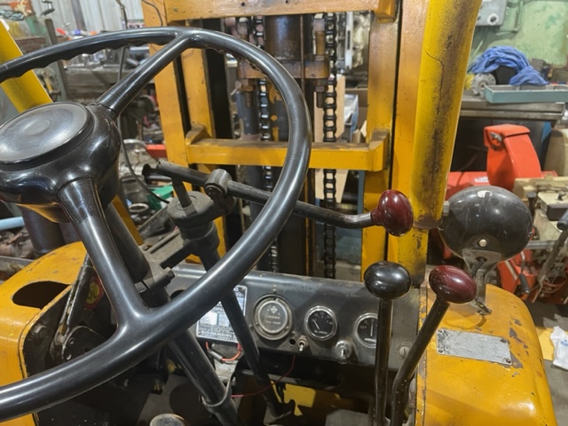

Yes, the high and low range moves in the same plane as the steering shaft. (Up and down)  Forward and reverse is moved around the steering wheel.  I try to get a couple photos.

First photo is High range.

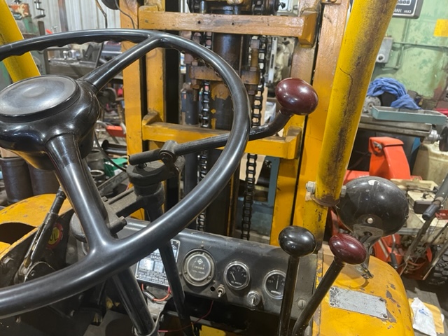

Second is Low range.

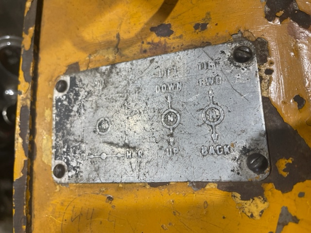

Third is the tag, best could get it is worn.
