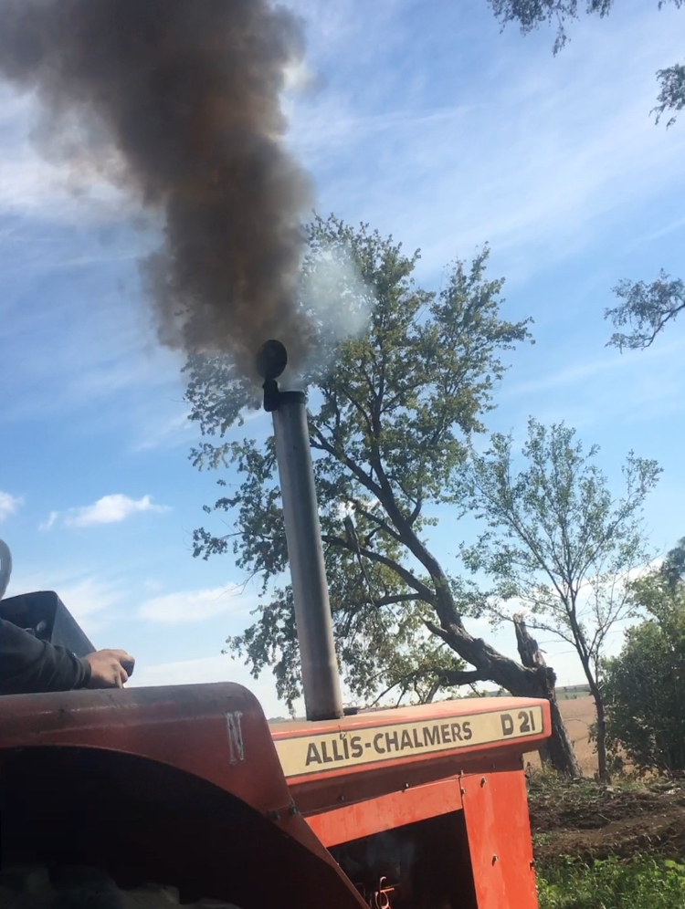

Yes, he’s grinning ear to ear!!!
None of his kids/grandkids have an interest in these old tractors so he was happy that someone in the family has the orange blood…
That’s me driving the 21 in the picture above…
