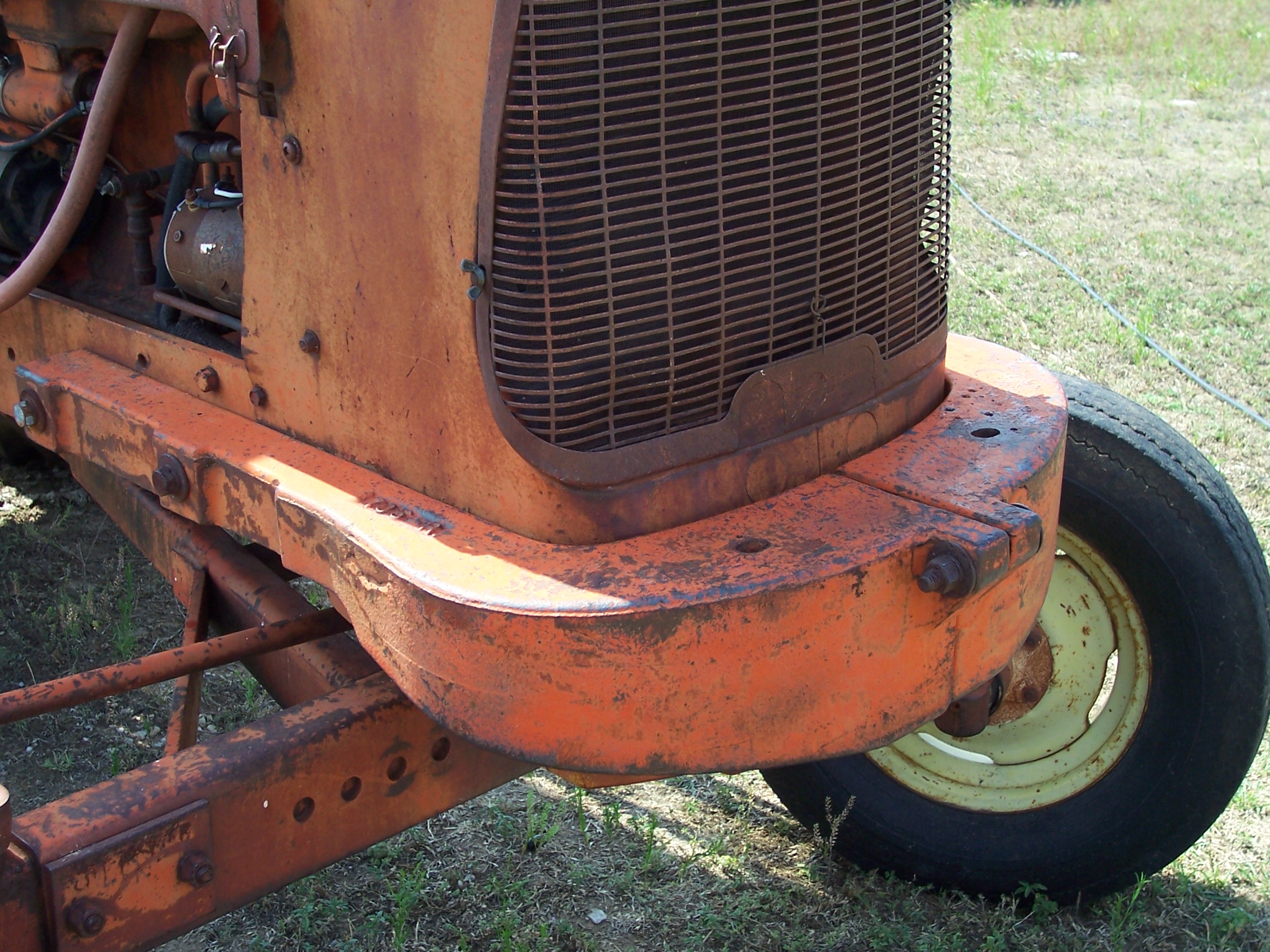

Here is a picture of the weight on my D19
Anthony View Drop Down
Location: Alva, Oklahoma
Points: 731
Post Options Post Options   Thanks (0) Thanks(0)   Quote Anthony Quote  Post ReplyReply Direct Link To This Post Posted: 09 Jul 2019 at 9:35pm
This is it
Joe(TX) View Drop Down
Location: Weatherford. TX
Points: 1682
Post Options Post Options   Thanks (0) Thanks(0)   Quote Joe(TX) Quote  Post ReplyReply Direct Link To This Post Posted: 09 Jul 2019 at 10:27pm
That's my tractor. I now have the cab off.
