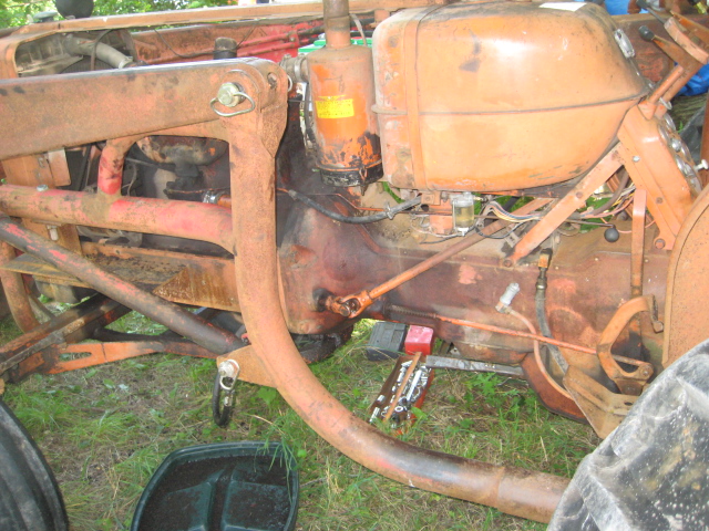

Thanks for the replies.  I scraped off the dirt in that location but no  number.  There are a couple of numbers on the lift arms  4454-b. pictures

Your D-17 is a 1957,58,or early 1959. The serial number is just below the air cleaner on the torque tube where the engine bolts up and the side frame bolts in. There should be a flat spot on the slope part. You may have to clean it real good because the number is stamped in.

Look at the picture Claus posted. You can clearly see the front frame rails are bolted to the torque tube, or torque housing and you can see the numbers stamped in the housing flange. If yours doesn't have numbers stamped there it must have a replacement housing. If you can find the engine number, maybe somebody could compare it to theirs and get you close.

Corbin, see where your fuel line crosses over where the back of the engine and the next big casting (torque housing) is? Looks like close to the end of your rubber hose where it is clamped on to a metal tube going to the carb. Compare that area to Claus's pic. If it has a serial #, that's where it is.
