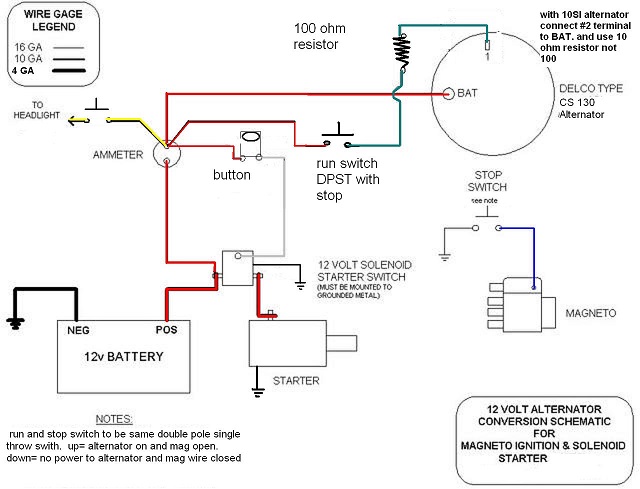

some have installed a push button for a starter... Does yours have the PUSH ROD to the starter motor, or does it have a SOLENOID installed in the circuit..
Toggle for the lights... The other is an ignition ON switch or a magnito KILL switch.
below is the wire diagram on mine..... it has an alternator, not a generator...

If you have a magneto its possible the push button is a KILL BUTTON for the mag.. hold it down till the motor dies, then let go.... On a distributor, you would need a toggle switch for CONSTANT power to run............ how do you KILL the motor right now ?
But if the button is the KILL, then you still need to see what the other TOGGLE is for.. possibly a rear light or ?
