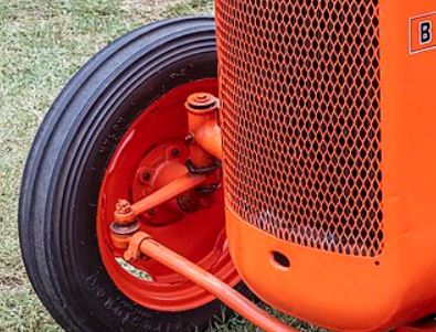

https://upload.wikimedia.org/wikipedia/commons/thumb/4/4d/Allis-Chalmers_B_tractor_VA2.jpg/1149px-Allis-Chalmers_B_tractor_VA2.jpg?20210728030228
The hole is on the top of the shaft. In this picture on top of the shaft is a bolt and washer.

OK... i see what your talking about now.. The spindle is right side up and NORMALLY the ARM is on the TOP to hold it in place... On this tractor, the ARM is slide over the spindle, then slid into the tube and needs something ON THE TOP to retain it... so the TAPPED a hole and put a bolt and washer... There is no hole from the factory.. you can drill and tap whatever you want.. If yours DOES have a hole, someone added that.
