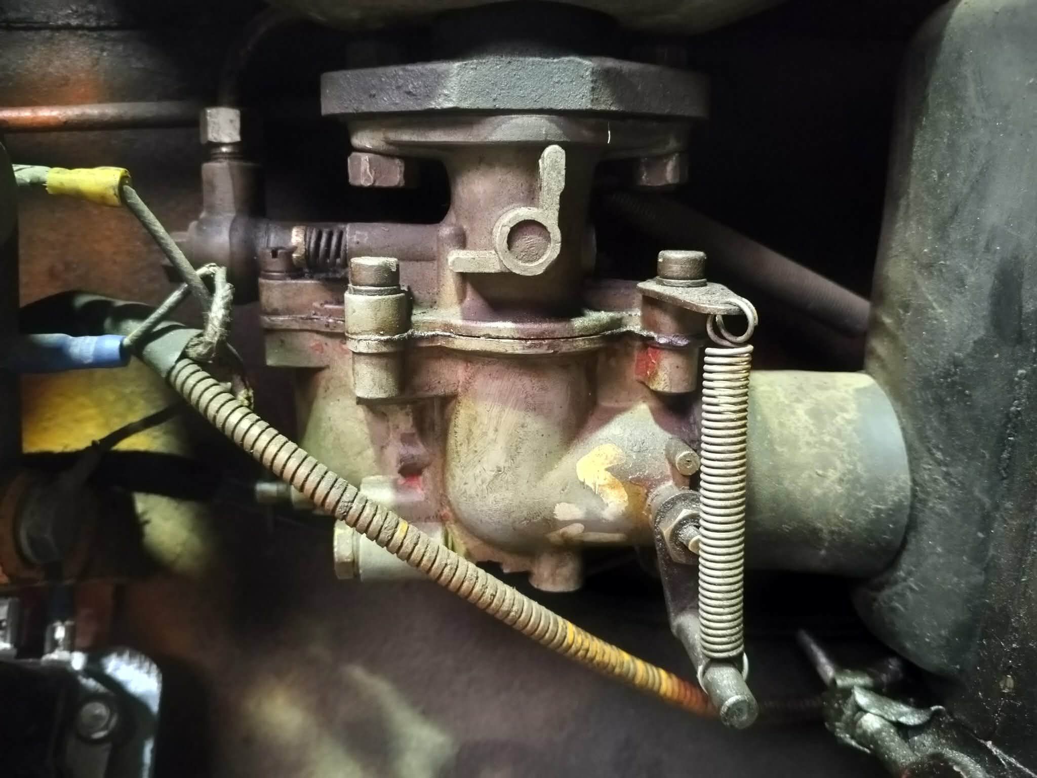

No letters/numbers on the carb, can anyone tell me if this is a Zenith or a Marvel Schebler carb?

Post Options Post Options   Thanks (0) Thanks(0)   Quote Gary Burnett Quote  Post ReplyReply Direct Link To This Post Posted: 1 hour 17 minutes ago at 7:45am
Zenith

Post Options Post Options   Thanks (0) Thanks(0)   Quote wjohn Quote  Post ReplyReply Direct Link To This Post Posted: 42 minutes ago at 8:20am
That is a Zenith, but I have never seen that style on a B. If you look at where it mounts to the manifold, it looks smaller than it should be. I wonder if it came off of something else and is not the original carburetor... Unless that is what Bs built in the UK used?
