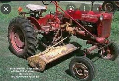

I did see a FLAIL on a Farmall CUB so YES, it will work on a B... but it was best at cutting the grass every week. Did not do a good job when the grass was 12 inches deep.

About 30 years ago I made one of those cub flail mower into a pin hitch mower to work behind a CA. It kinda did an OK job, maybe it needed new sharp knives? I unloaded it at a consignment sale.

Kyle, do you have a photo of how your flail connects to your present tractor ?  Can compare to the back of a B to see how / what kind of modifications would need to be done.
