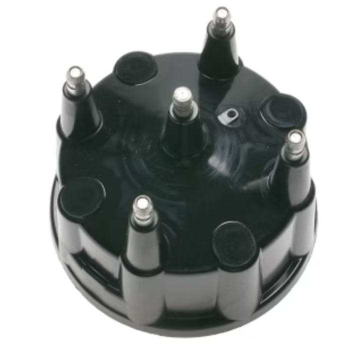

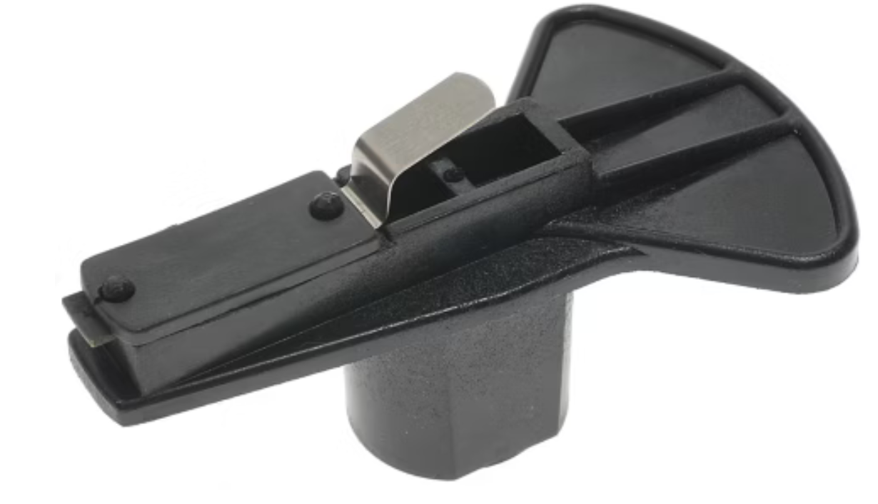

but what I actually have looks nothing like this especially the cap and rotor which look like this:
so I'm not even sure if this distributor is original to the machine
