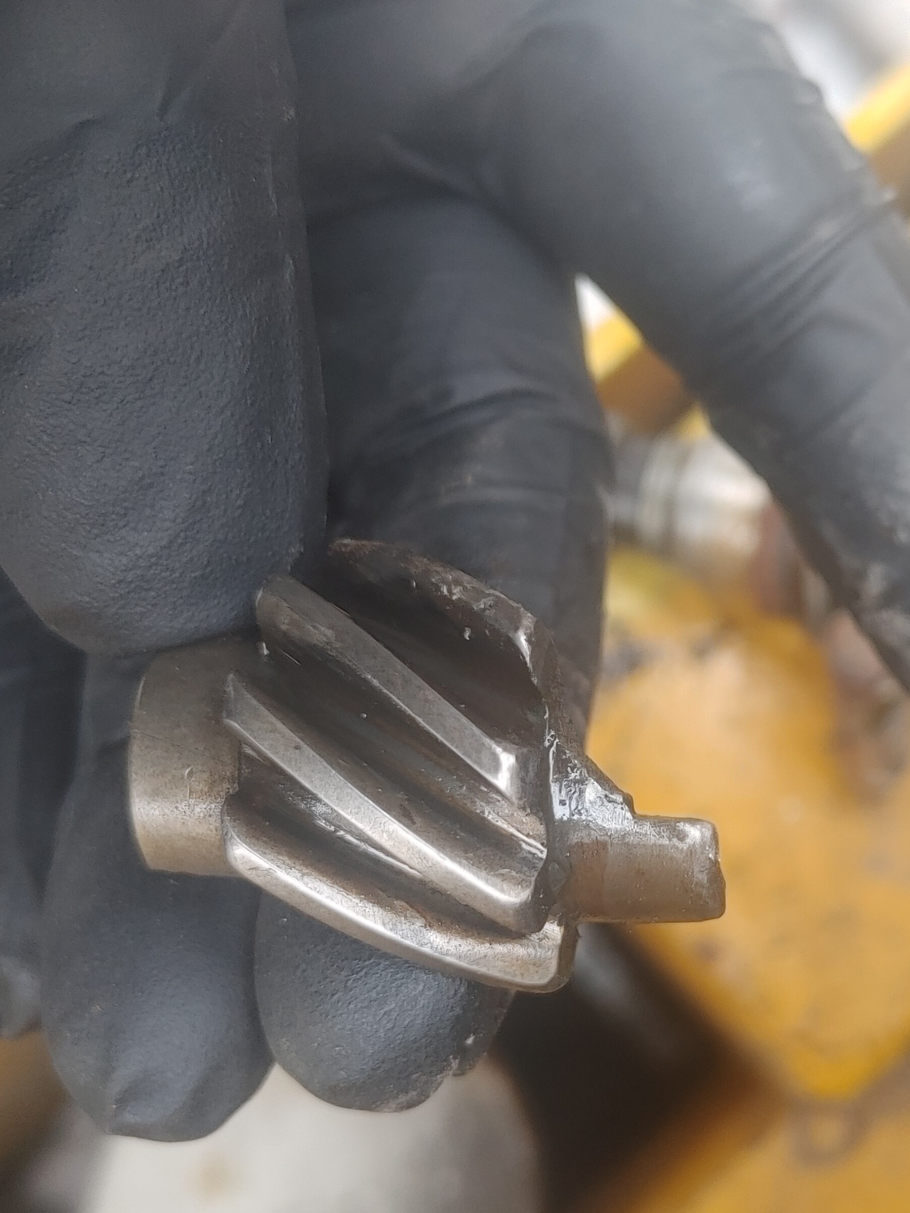

Can anyone help with my allis Chalmers G153 engine acc 40 lp forklift
The gear broke on the end of my distributor and I cant seem to figure out the part it isnt listed

If the tag is still on the distributor it will be a big help in tracking down a gear as some of these distributors are widely used in other equipment also.

1112 460 is the distributor # all of the distributors I found dont have the gear attached
It apears the 2 notches slide into the gear

Not sure what todo @ this point

there is a guy on e-bay selling a cam shaft and crank shaft... might contact him and see if he has the gear drive off the cam..

Genius !!! A diffrent way of thinking!
I Will reach out to him and see if has one
