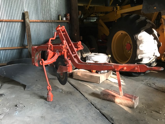

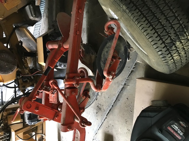

Guys,
I have an opportunity to purchase the two bottom plow in the attached pictures.  I have a series I D12 that I show.  I would like to attach this plow to the D12 to show, not plow with.  My D12 has snap coupler lift arm hands.  The plow looks to have a different type of lift arm connection.  It looks as though it has sockets for a type of lift arm that is straight metal that fits into the pocket.  Does anyone know how to make this fit my D12?  And, is this truely an Allis Chalmers Plow and what vintage is it?
Thanks in advance for all your help.
Bob

That is a 52? I think.It was a pin hitch plow some one has welded a snap coupler eye on it.The lift bells are std  for that plow.Made for a WD. Have one like it. Ours is 2-16's.
Solid lift links and snap coupler pull are not a wise combination.

That is designated as a “WD pickup plow” trying to attach it to a D12 will put your frabrication skills to the test. Even if you are only wanting to use it for show the comment you are going to hear the most is “That is not the correct plow for that tractor” you want to find a snap coupler model #52 or #62 to be correct for what was availble at the time the tractor was made, unless it is new enough to have been built afte the 70 & 80 series plow were being built.

Thanks for the response.  I want it to be correct.
