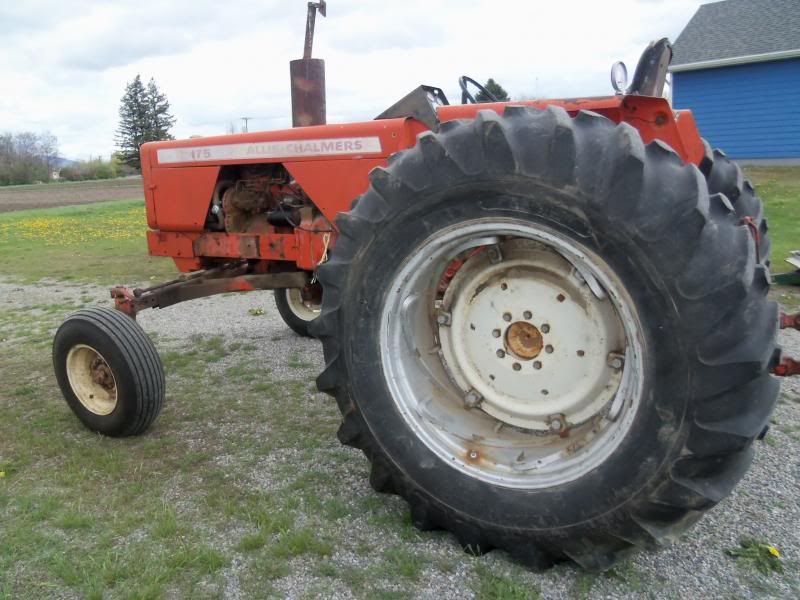

Either tire will make that 180 a real tractor!
My 175D with 6080 wheels

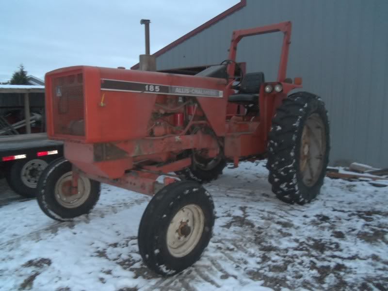

My 185 with 14.9 x 38's.....they are actually 2" taller than 15.5 x 38's

I have 18.4x34s on my 185. Road speed is around 19mph. I now go to this tractor for everything. Looks awesome also. Have to grind pilot hole in casting a little for 180.

I notice they are slid out pretty far in the photo is there enough adjustment in the fenders to get the tires slid in tight? Sounds like it would be worth the purchase.
I raised the fenders later and moved the tires in. Plenty of adjustment.
