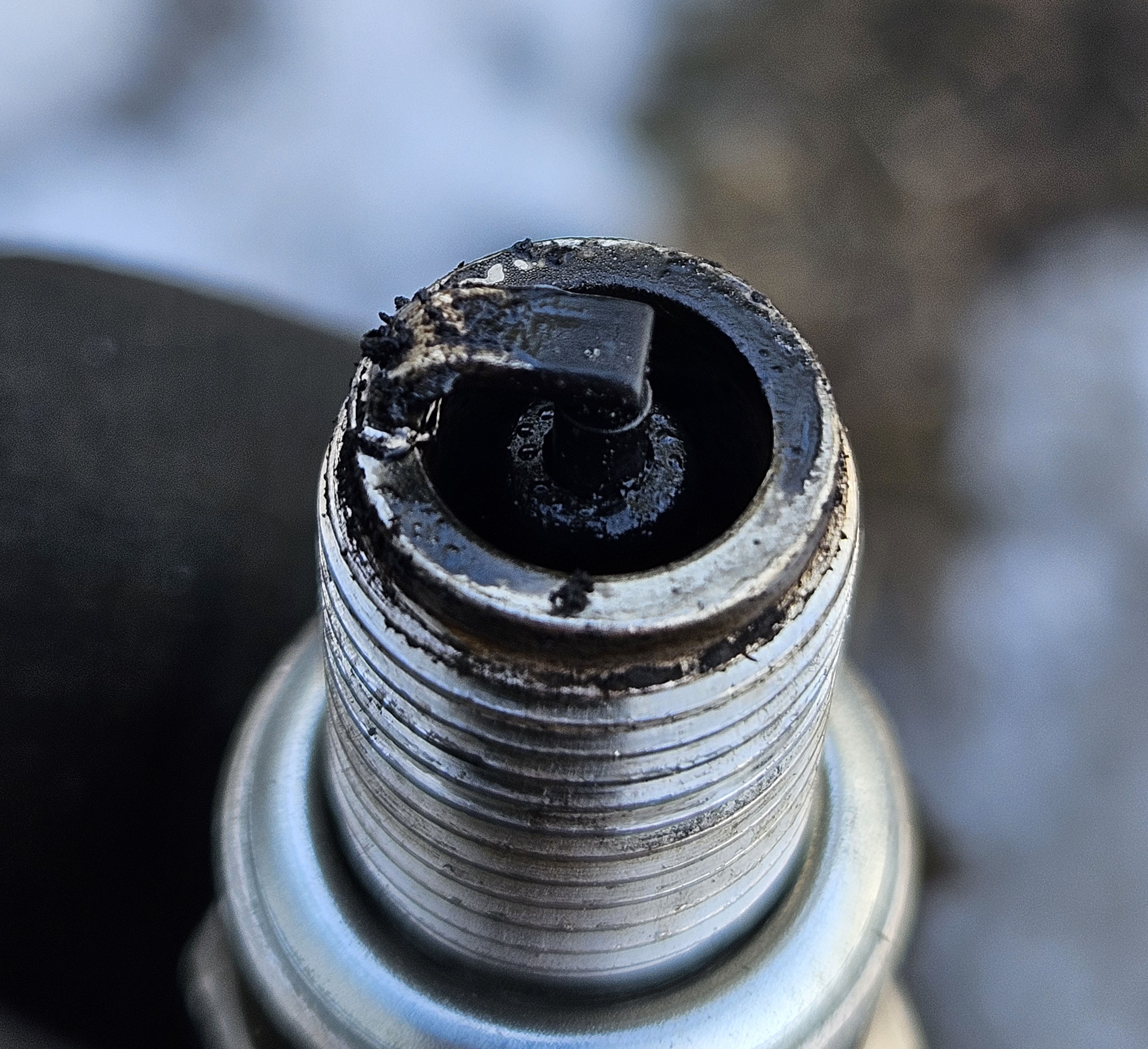

Hey there, it's been a while. I was able to pull the tractor into the barn for the winter and have been able to get a closer look.
There is no blue smoke coming out of engine.
I did notice where the coolant leak originates. It appears at the middle of the engine block somewhere at the back between the block and the plate between the engine and the fuel tank. If I fidget with the shield plate, the coolant runs quicker.
I could not seem to access the method of removal of the plate, so my guess would be, do I drain the fuel tank and remove fuel tank to establish where the leak is at the back of the engine block?

The coolant leak will be at the rear of the cylinder head. It is an expansive plug that takes a 7/16" wrench to tighten it. You may be able to snug it up but I'll bet you need to replace with new. Part available from AGCO only. Hood and fuel tank likely will need to be removed to gain access to this area.  I'd get a new one so you can see what you're dealing with.

I have been progressing slowly, waiting for some gauges to come in and she's hard to start in the freezing cold barn with a weak battery that's due to be replaced as well.
I ran her for a few minutes, then checked the plugs, they were fouled with oil.
Could this be because I'm having a hard time starting her, there's no combustion happening, and keeps just cranking without the ability to burn off the oil?
Or is there something larger at play here that I'm missing ?
The older plugs Acdelco r43ts that I pulled out of her, didn't seem to be right for this tractor, but they weren't fouled with oil, just a bit sooty but not too bad.

Originally posted by ElementalEarth ElementalEarth wrote:
I ran her for a few minutes, then checked the plugs...
Cleaned out the air filter, but it's so nasty that might need to be replaced...
That engine needs to be warmed up fully and worked hard, but first, do whatever is needed to ensure a properly functioning air cleaner. Then you will be able to get a better idea as to what you need for spark plugs (heat range, etc.).

That tractor uses AC Delco R-45 XL or R-45 XLS LONG reach plugs !!!!!!!!!!!!!  Gapped at .025" .
Edited by DrAllis - 21 Feb 2024 at 6:31am
Points: 8978
Post Options Post Options   Thanks (1) Thanks(1)   Quote SteveM C/IL Quote  Post ReplyReply Direct Link To This Post Posted: 21 Feb 2024 at 6:58am
A 45 is hotter than a 43. Probably not the reason you're having trouble starting.

The new plugs, the autolite 405, didn't seem to properly fit either. The acdelco I pulled were fit snug and tight, but the autolites, there's a lot more resistance when threading them in, I am worried over tightening and stripping something out on the threads.
I can crank them in harder with probably a couple more turns, I'm just concerned I'm damaging the holes if I do..
Not sure why that is, they should be the right ones for this tractor no ?
As Dr. Allis pointed out above, the plugs need to be LONG reach; if short reach plugs were used then the threads are contaminated with carbon deposits and need to be cleaned out with an appropriate tap to prevent further damage.
Shoot, are you telling me the Autolites 405  are no good? Honestly I don't know the difference between long and short reach, but I guess I could find some ACdelco R45XLS somewhere online.
