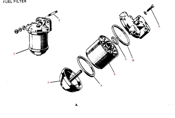

Ed is probably on to the issue - NAPA and others sell the WRONG filter for AC's and MF's . They have the correct filter but their charts are wrong - we called them with a # our local NAPA gave after we explained the issue. The man on the phone told me "we are napa and sell more filters than anyone - we don't need your input..."  Anyway look at the TOP of the filter - it should have HOLES in the top and bottom. IF the top of the filter is solid flat metal with a small slot around the edge - the flat oring - if over tightend or when it gets old will block off the fuel flow.  We have probably a hundred cases where the wrong filter affects fuel flow and resulting issues.   On my 160s I have issues with plugging in the drain cock - the FIRST sediment bowl and then the first inlet banjo bolt fitting going into the manual fuel supply pump.  When you have a good supply pump and fuel flow fuel will gush out of the fuel pump bleeders. Whether the plungers are stuck or not is not an issue as to bleeding as Ed stated -if you get a good stream out of the lower bleeder then loosen one line and turn it over - if you have run the battery down pull it in high gear to avoud starter damage. When fuel comes out stop and tighten line and it will start. If you get no fuel the plungers could be stuck or you have no transfer pump pressure -- a real low occurrence. .  Also after thinking - we have seen the oem fuel line come apart and block flow - these can be repaired but grinding off the brass collar the crimps the hose - pulling out the banjo fitting and reinstall some good american made fuel line and hose clamp. This works on all lowe pressure rubber lines on Deutz-Perkins - SAME etc engines.

good info T! I have not seen those filters fail in use, it is the owner/installer mistakenly installs a rubber seal ring inside the top lip of the filter, right where the fuel passage is lol! Not sure what they thought that was going to seal up there, except fuel flow lol! The seal for the top goes in a groove in the filter header, then below the element, or between element and glass bowl. Small oring seals the center post keeping dirty and clean fuel separated.

From the AGCO online parts book.

I posted the picture from the parts book so you can see the 3 rubber gaskets.
And yes, out there for sale is a mess of filters and parts. Same for the cartridge style
oil filter.
