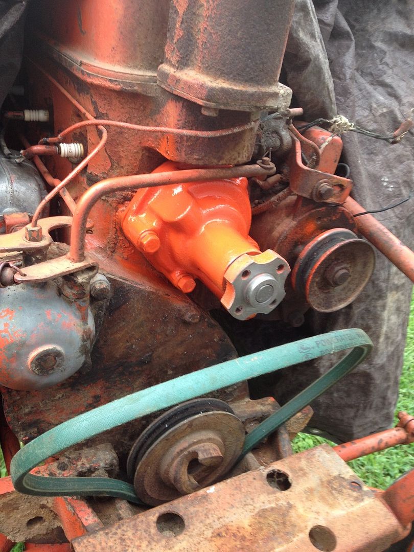

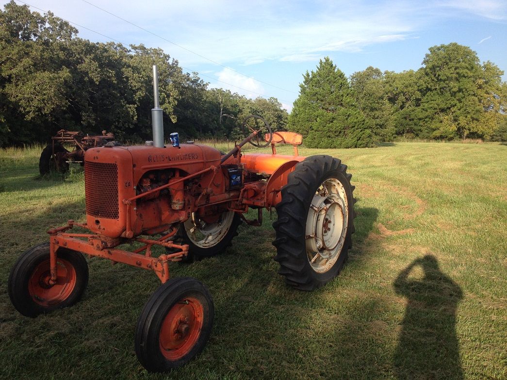

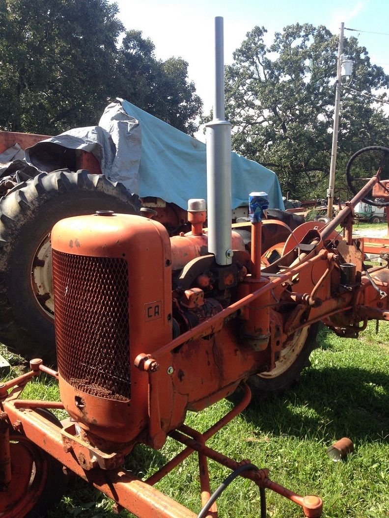

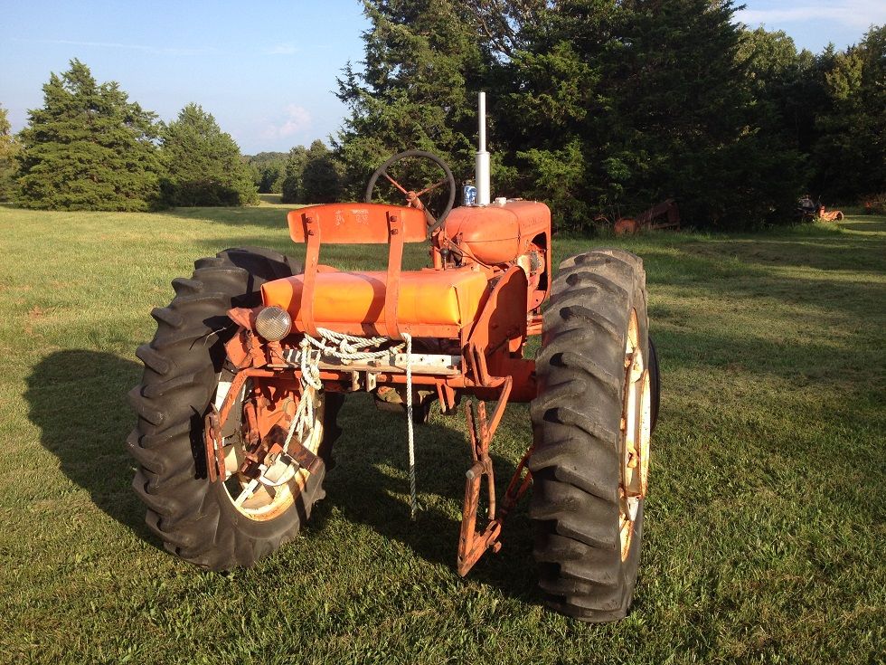

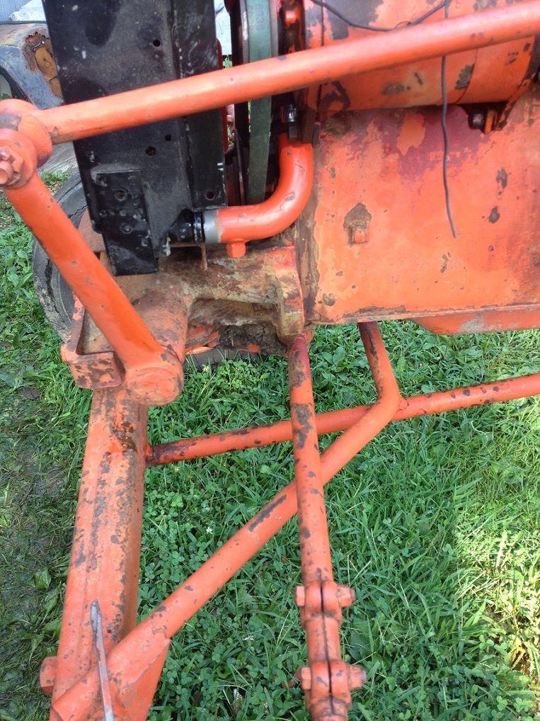

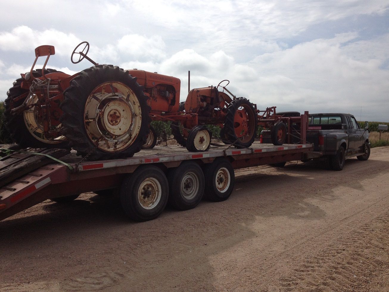

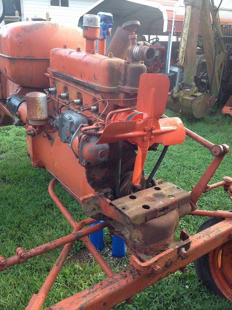

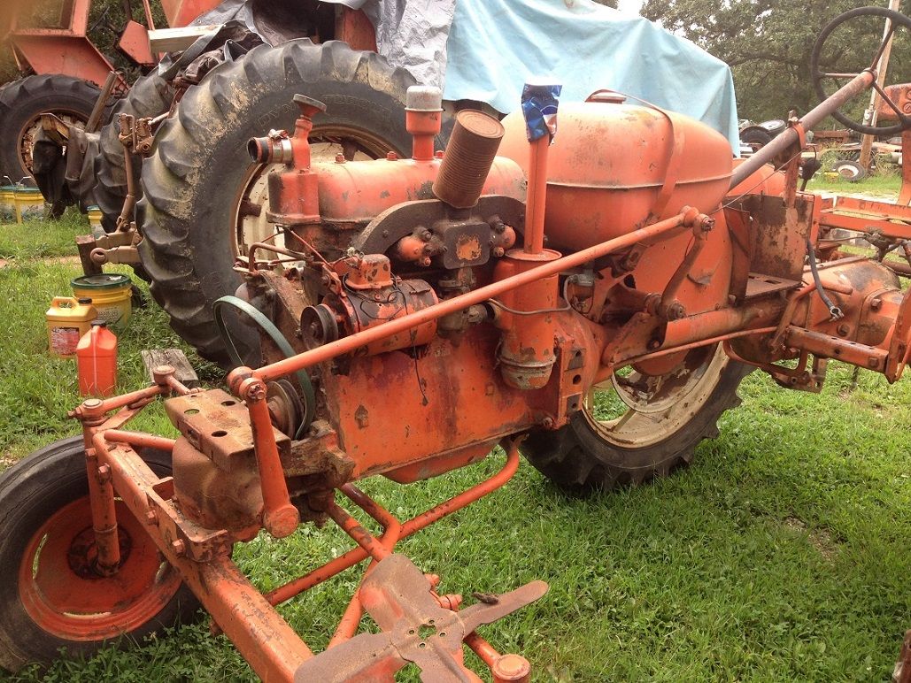

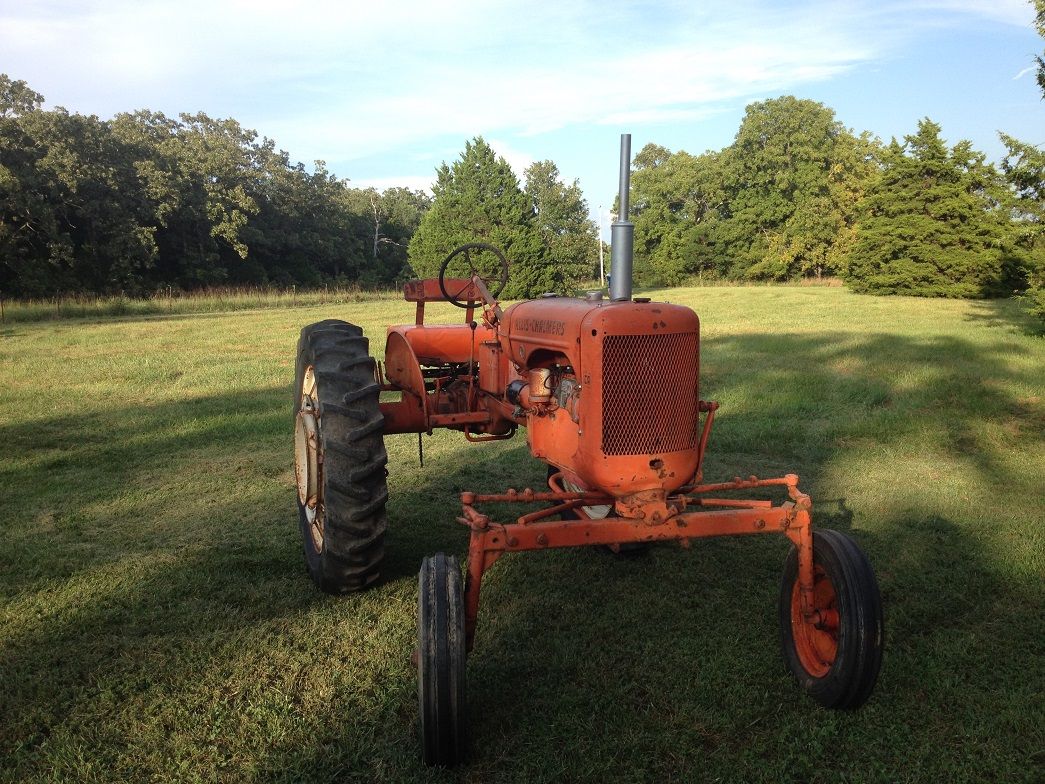

This is the one I recently bought from Mn.
Tractor was built into high crop with 36" rear wheels.
Tires will need replaced but for know they will work.
Parts replaced were the water pump.
lower radiator pipe had to cut off about 3/8" to get to fit may have been the Radiator that caused the issue.
Also the radiator was bad, so I had new one the shelf for about 10 years decided to use it.

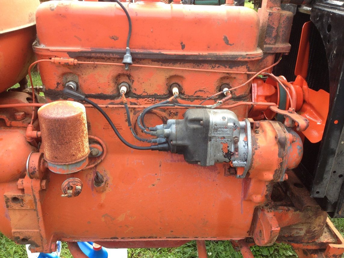

Change out the spark plug wires and shifter boot and knob.
Clean the points and put I new resister on the mag.
Clean the gas tank out some had normal tar and rust in it.
Still will need some work but good enough.

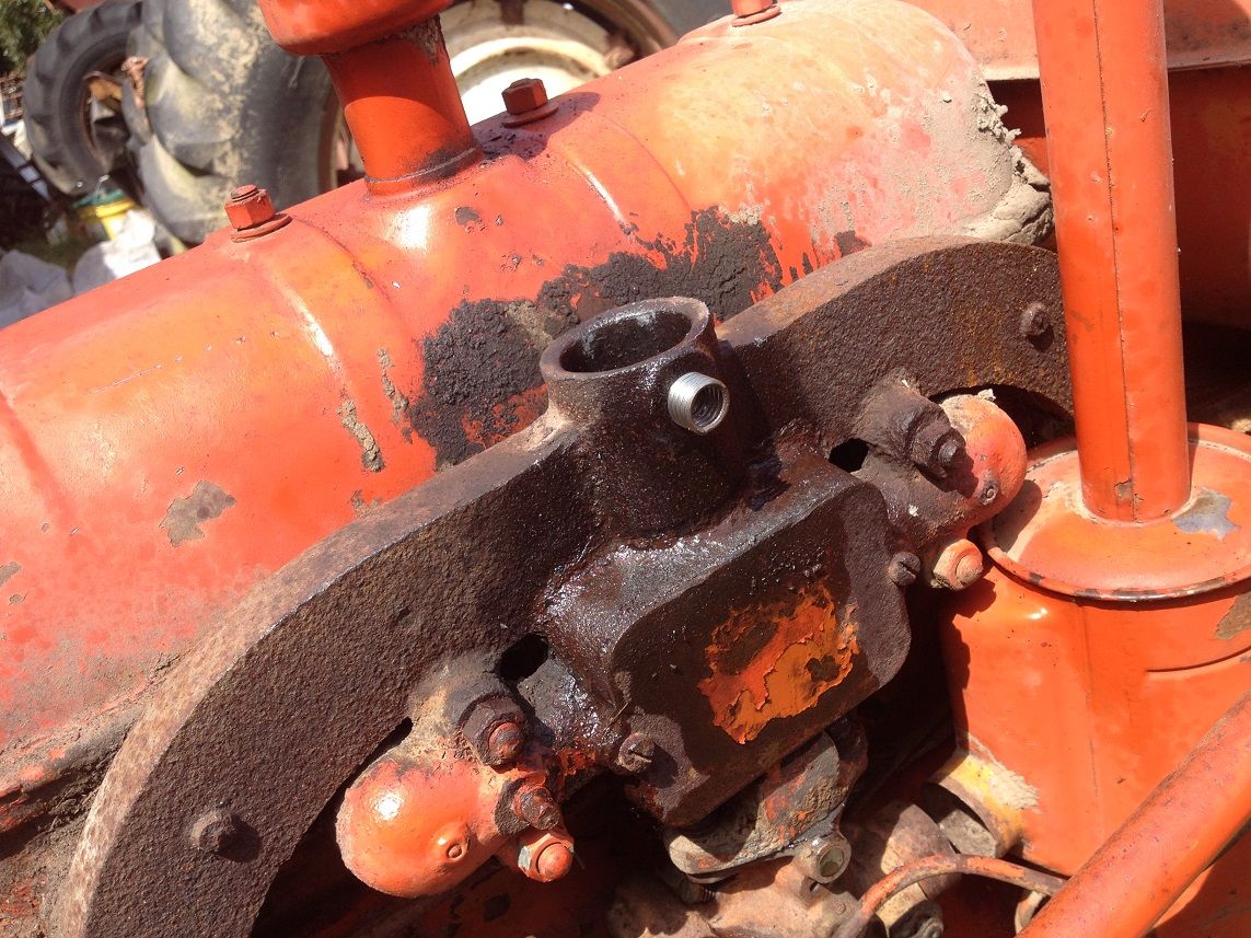

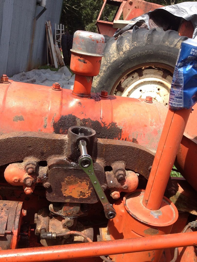

Also decided to make the manifold work with the new type of mufflers.
Had to cut off the muffler and also tap out the hole and install helicoil.
