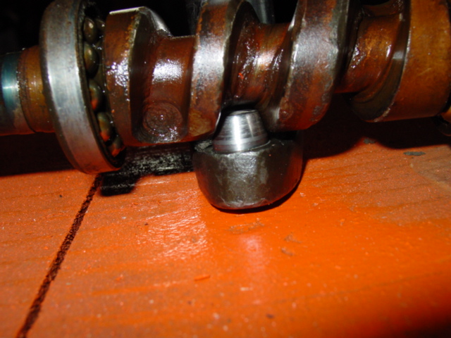

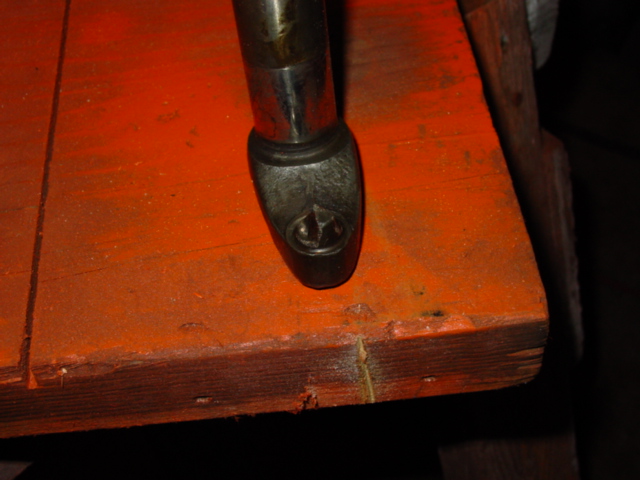

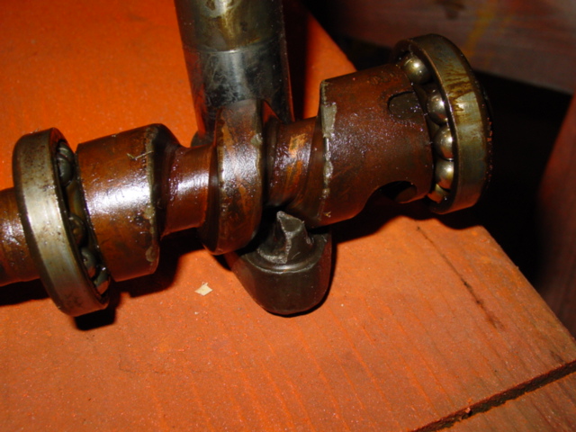

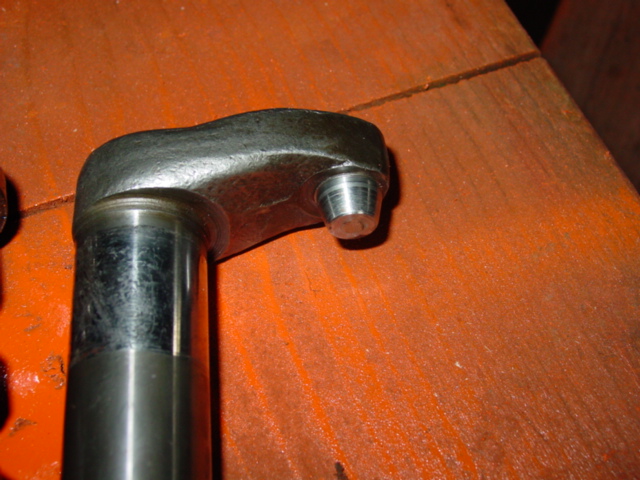

If your lucky! All I have tried to adjust didn't help as the pall/pin inside was wore down. I made up new palls.
[IMG]https://media.fotki.com/2vBU9zdVxevZ4.jpg[/IM

Post Options Post Options   Thanks (0) Thanks(0)   Quote Dick L Quote  Post ReplyReply Direct Link To This Post Posted: 01 Nov 2017 at 7:02pm

That would be the Gemmer that Kevin has. I have pictures of the gemmer some where but couldn't find them tonight for some reason. an old age thing I suppose.
