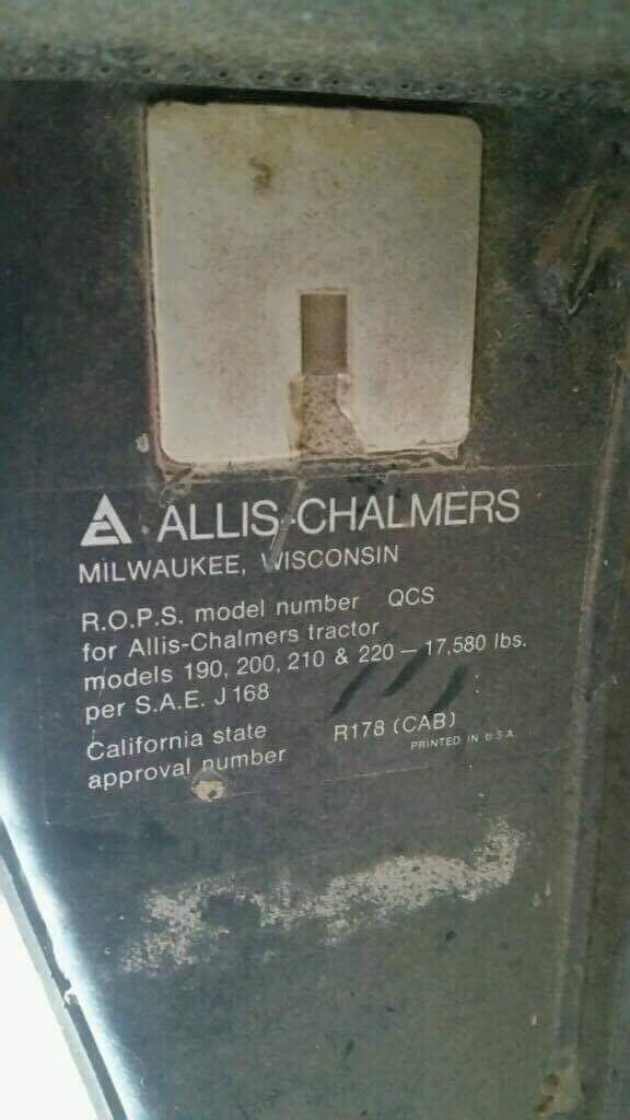

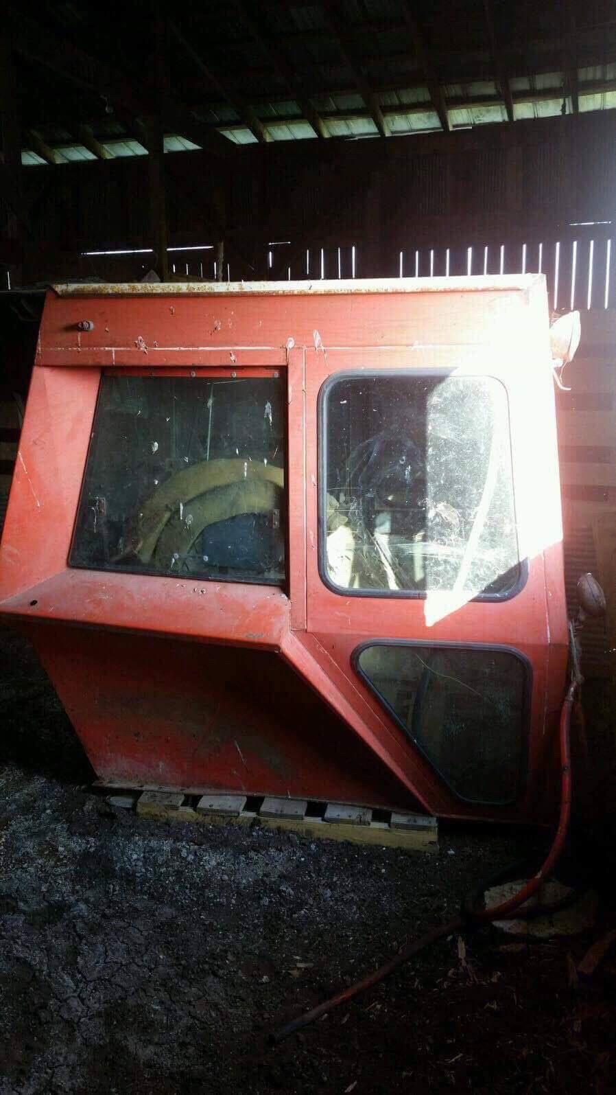

Hey guys. I’m buying an Allis brand cab for a 200 to put on my 190XT. The cab is in good shape with heat and AC. Does anyone have any experience with these or input on them? Attached is the only pics I have of it.

Make sure you get the mounts for AC compressor. If they don't come with it you will need to find a donor tractor somewhere.

I don't see any framework for the cab to sit on.  Bolts to the bellhousing and rear axle. This is a roll-over protection cab.

I did that a couple years ago worked pretty nice just make sure to use the frame work I might have the a/c brackets yet if you need them

I talked to the guy im getting it from. He has the mount for the compressor and the cab rail so I won’t be needing them.
