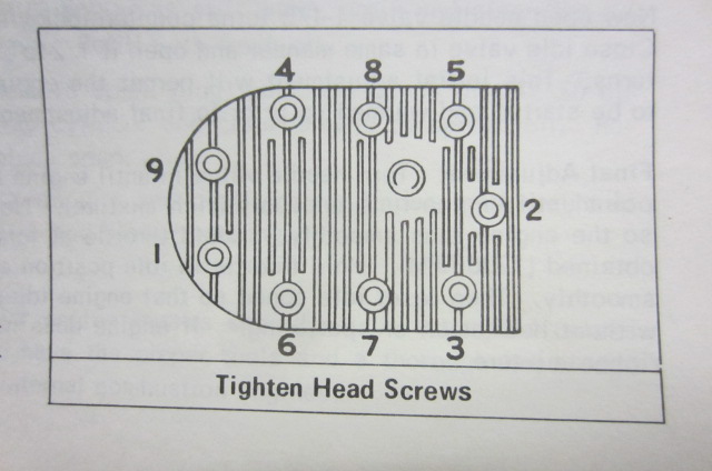

Yes, bolt pattern and torque specs please.  Thanks

Post Options Post Options   Thanks (0) Thanks(0)   Quote farmtoybuilder Quote  Post ReplyReply Direct Link To This Post Posted: 04 Apr 2015 at 11:10am
190 inch pounds or you can do as text says.
