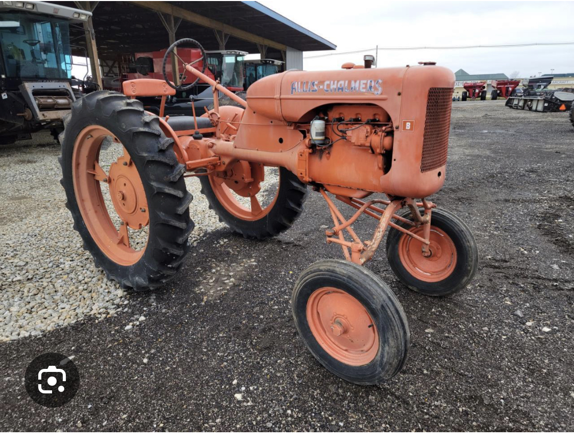

This one has the wheels outset instead. So it has normal fenders.

As per the parts book, the Asparagus special had 38" rear tires. The Potato Special had 28" rear tires.

Gesh, it’s hard enough to get on and off of a normal B how do you get on one of those?
I hope somebody can dig out their Swinford book. I think maybe I am mixing up the fender deal with the potato B.
The pic I put up is an asparagus model with the 38s.
Does the parts book show potato fenders by any chance ???

Just looking in Swinford's book, page 53.  The potato 'B' had the handbrake levers outside the fenders.  the Asparagus Special had them inboard. It had 29 inches clearance under the front axle and 28 inches under the rear.
