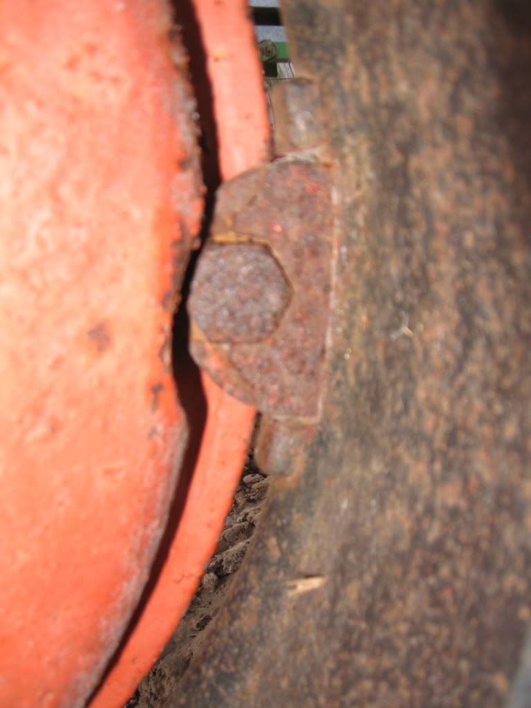

Original mid to late prtoduction 38 rim locks look like this.  The footed clamp fit behind and over the short angle tabs rivited to the bottom of the bead flange on very narrow rims. The ones used before this were special for the 37 & early 38s with the split rims. You can also tell a 38 wheel center from all others by looking at the valve stem notches. They are half round and not the usual  V notches. The bolt holes are 3/4 also. Not 5/8
