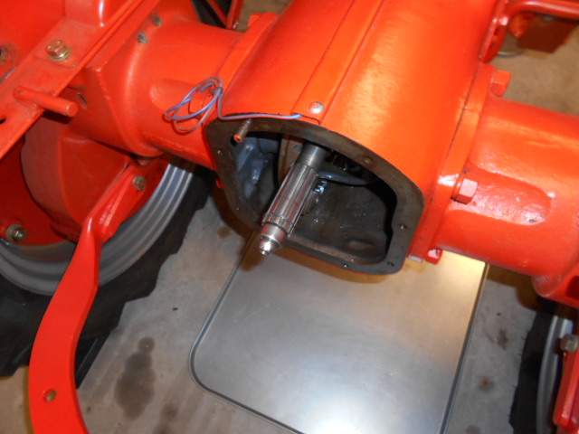

Post Options Post Options   Thanks (0) Thanks(0)   Quote BEK Quote  Post ReplyReply Direct Link To This Post Posted: 27 Oct 2020 at 9:48am

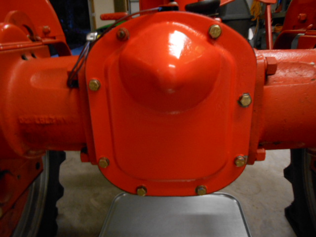

Cover plate installed.  Filled the transmission with new fluid.  No leaks yet.  Wink  I just need to bolt the seat frame back on the tractor.  I don't think the cover plate makes the tractor more useful, but it does clean up the rear end.

Post Options Post Options   Thanks (0) Thanks(0)   Quote BEK Quote  Post ReplyReply Direct Link To This Post Posted: 27 Oct 2020 at 9:42am
All cleaned up and ready for the cover plate.

Post Options Post Options   Thanks (0) Thanks(0)   Quote BEK Quote  Post ReplyReply Direct Link To This Post Posted: 27 Oct 2020 at 9:41am

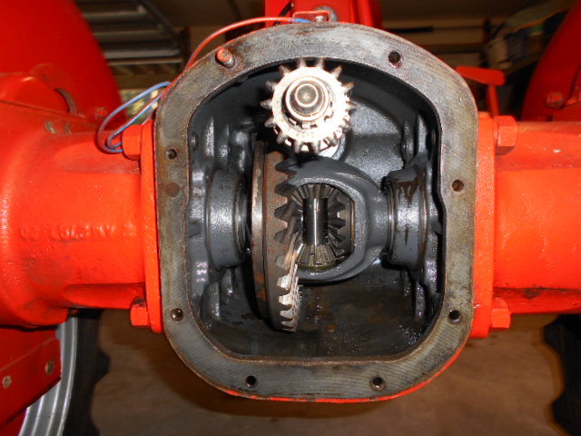

Everything inside looks great!  Not bad for a 70 year old.

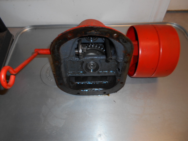

FYI.  I'm keeping the PTO.  It will stay with tractor in case I want to put it back on.  There was nothing wrong with it and it does work well.

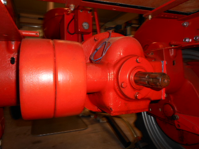

Post Options Post Options   Thanks (0) Thanks(0)   Quote BEK Quote  Post ReplyReply Direct Link To This Post Posted: 27 Oct 2020 at 9:34am

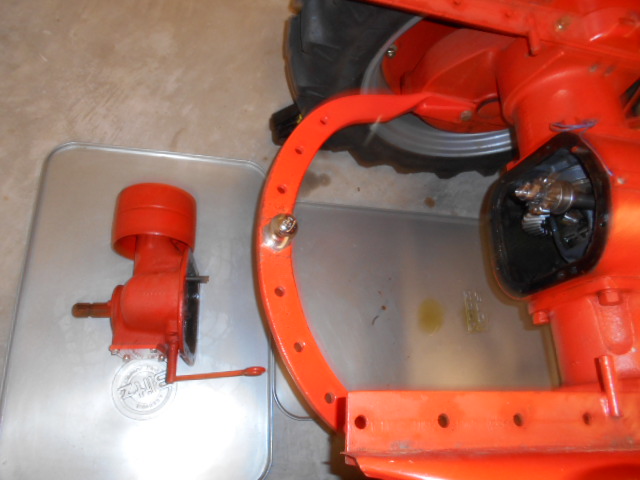

The PTO is off.  I was amazed at how easy it was to remove.  Slid right off.  Thanks to those who provided info on how much a PTO weighs.  It was heavy but easily handled by me.

Post Options Post Options   Thanks (0) Thanks(0)   Quote BEK Quote  Post ReplyReply Direct Link To This Post Posted: 27 Oct 2020 at 9:29am

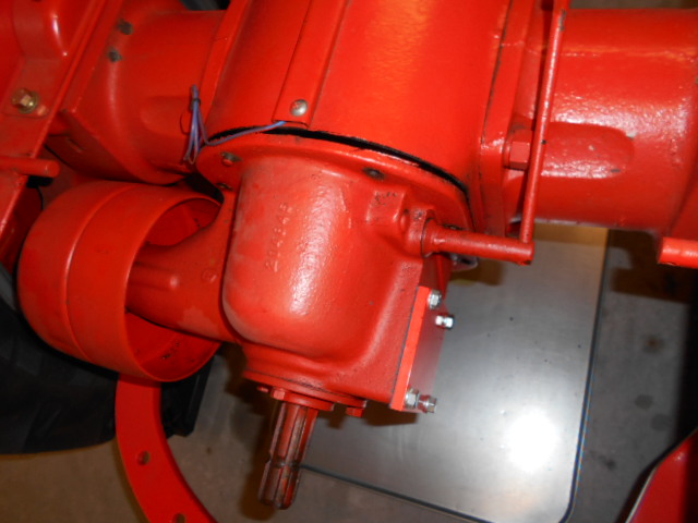

The PTO unbolted.  A couple of taps with a mallet and the seal was broken.

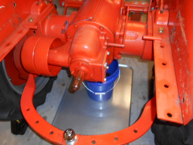

The seat and seat frame removed.  Draining the transmission fluid.

Post Options Post Options   Thanks (0) Thanks(0)   Quote BEK Quote  Post ReplyReply Direct Link To This Post Posted: 27 Oct 2020 at 9:25am
I have been debating this project for a while.  To remove or keep my PTO.  I always thought the B's with the rear end cover plate was a different feature you don't see too often.  Since I don't have any powered implements to go with this tractor I decided it's time.
The unsuspecting victim.
