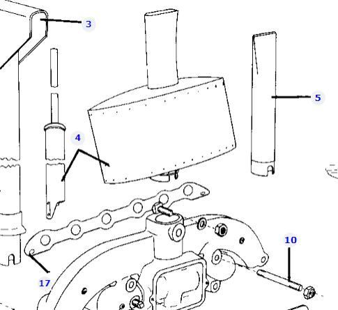

There should be a clamp bolt that engages with an open slot in the bottom of the muffler, as shown below.
As another option, you could go with a thru-type muffler (left item #4 above).  The thru-type looks a little better, in my opinion, but wasn't available from TSC or Fleet Farm last I checked.  I got mine from here:  Allis Chalmers Muffler Thru Hood - Vertical Round Body | ACS103 (jensales.com)

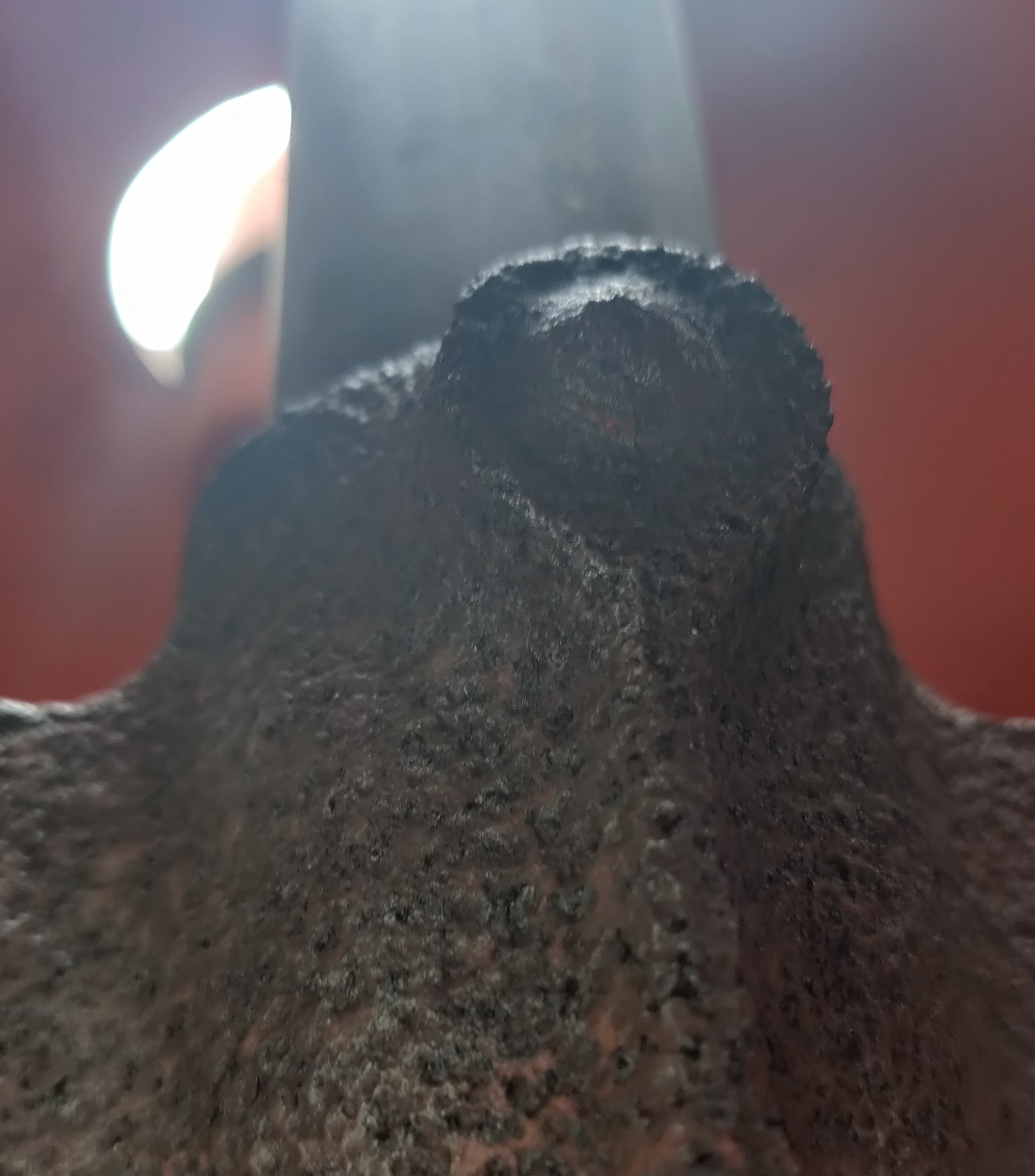

I'm geussing this is the bolt I need to take out...or what's left of a bolt... It's hard to see but it's at the top of the manifold

YEA... that wont be coming out anytime soon !!... You can  grind flush, drill it out , if it wont PUNCH out .......replace it or thread a pipe nipple inside for the exhaust to set OVER..
Edited by steve(ill) - 09 May 2021 at 4:35pm
Points: 89156
Post Options Post Options   Thanks (0) Thanks(0)   Quote steve(ill) Quote  Post ReplyReply Direct Link To This Post Posted: 09 May 2021 at 4:37pm
you might even want to cut the exhaust pipe off FLUSH so you can see inside and help grab the bolt head.
another possibility is to cut the pipe off with  2 inches sticking out... Then buy a muffler that will slide OVER the old pipe ( assuming the pipe is still good).... I actually have a tractor like that, i slide a 90 degree elbow over it that goes thru the hood and points forward to the left side of radiator. Mounted the muffler horizontal so it dont catch braches under the trees.

Underhood mufflers are cool, but two problems there. Paint peels off the hood eventually from the heat, and the exhaust is constantly in yer' face. Upright version is better providing you don't have a lot of tree's to go under like Steve does. When I first started restoring my B 20 years ago, my manifold looked just like yours with the bolt rusted off. I did just what Steve explained, I ground the bolt flush, found center and drilled my butt off. I actually got to the threads and saved the threads in the manifold! I was amazed myself that it came out that good! I used a lot of Antisieze on the new bolt when I re-installed the new muffler....  Thumbs Up
