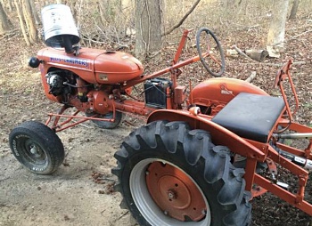

Had a lot of issues trying to get my 48 B in time. Noticed a lot of play in the distributor and remove it to check gears. No oil in the reservoir and the the gears were chewed. Found a rebuilt DELCO REMY 1111411 (cross reference 1111735) on e-Bay that I picked up. Was just looking for a few tips in terms of re-installing this distributor correctly. Want to make sure I cover all of my bases. Thanks in advance!
