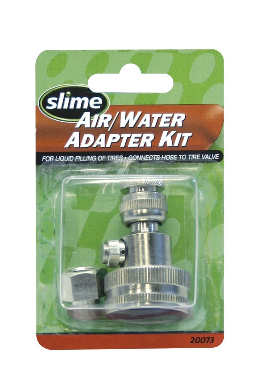

Get one of these from Amazon for about $10.00:
Then get an inexpensive transfer pump (Harbor Freight) and a couple of pieces of garden hose.  I pumped mine into a plastic garbage can then used it as dust control.
