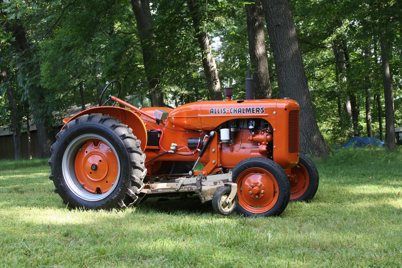

I put a D14 engine in the B that I lowered for mowing.
These are what I remember:
1. You need to use the B flywheel and clutch (D14 flywheel is too big for the B torque tube).
2. The 4 studs in front of the D14 engine for the radiator support and axle support are   bigger, need to drill out the support holes.
3. The manifold is bigger so neither the B or D14 air cleaner will fit, need to fabricate one.
4. Water outlet/thermostat housing different, need to relocate water temp gauge.
5. For the hood, the muffler hole is slightly different, the oil cap hole in a different spot, as mentioned air intake/air filter in a different spot, temp gauge hole not needed.
May be others I have forgotten but nothing that can't be overcome.
First picture is the D14 engine being installed in the lowered B.
Second picture is the finished project, I've been mowing with it for over 2 years, works great.
Edited by wbecker - 31 Jan 2016 at 1:11pm
