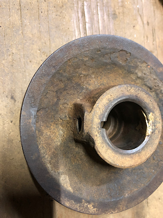

I’ve got a 1940 B that I need to swap out the crank pulley. We’re there different styles? Mine has a single 3/8” tapped hole that is supposed to lock onto the keyway. No other provisions for locking down the pulley. I’ve read posts about multiple set screw holes on these pulleys? Is one style better than the other and and are they interchangeable? Thanks everyone. You guys have been a great help.

Multipul set screws are short and on top of each other.

Did some have more than one set screw threaded hole?

no, there are two screw on top of each other, inside the same hole.

Ok thank you. Looks like mine ran loose for a long time and they tried to braze it on. Crank looks ok so let me know if you have a nice hand crank front pulley for my B. Thank you all.
