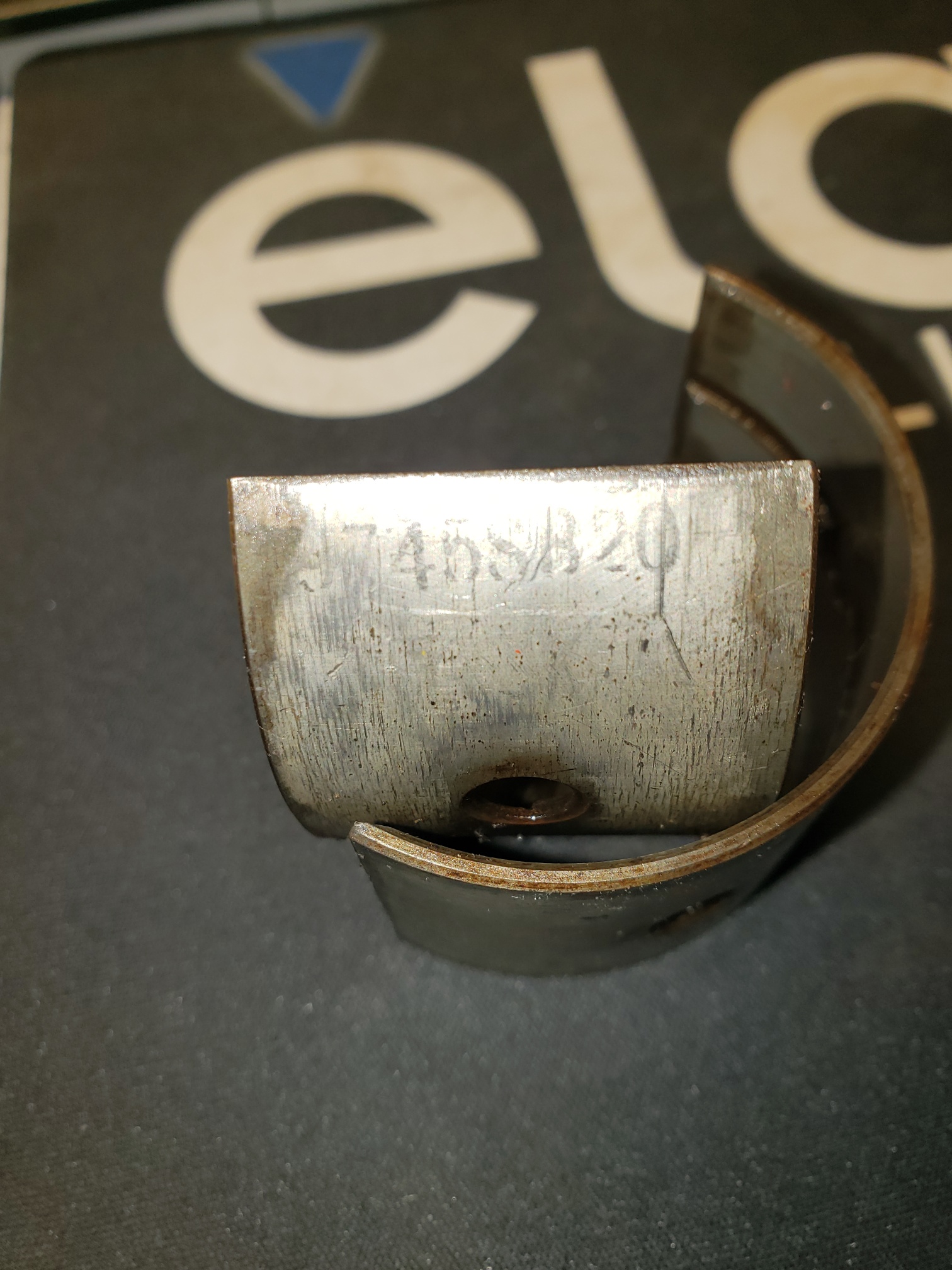

Post Options Post Options   Thanks (0) Thanks(0)   Quote DrAllis Quote  Post ReplyReply Direct Link To This Post Posted: 22 Dec 2019 at 7:53am
Look on the backside of each of your old bearing shells and they should be stamped -.020" or -.030" or whatever. They are probably -.020" and the crank is WORN, needing to be reground down to -.030" to accept new smaller brgs. Your Machinist wasn't much help.

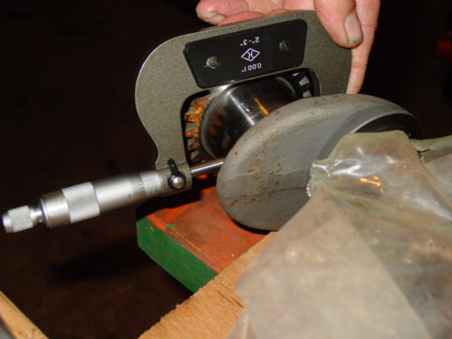

If you decide not to grind the crankshaft and use .020 new bearing shells they would need to be filed as shown in my pictures and properly shimmed to get .002 clearance at the rod straight down after crush. The pictures show how I measured the difference.
https://public.fotki.com/DickL/allis_chalmers_engi/filing-main-and-rod/

Post Options Post Options   Thanks (0) Thanks(0)   Quote gman54313 Quote  Post ReplyReply Direct Link To This Post Posted: 22 Dec 2019 at 2:27pm
The rod bearings are all stampedJ745SB20 the mains just stamped FM 67

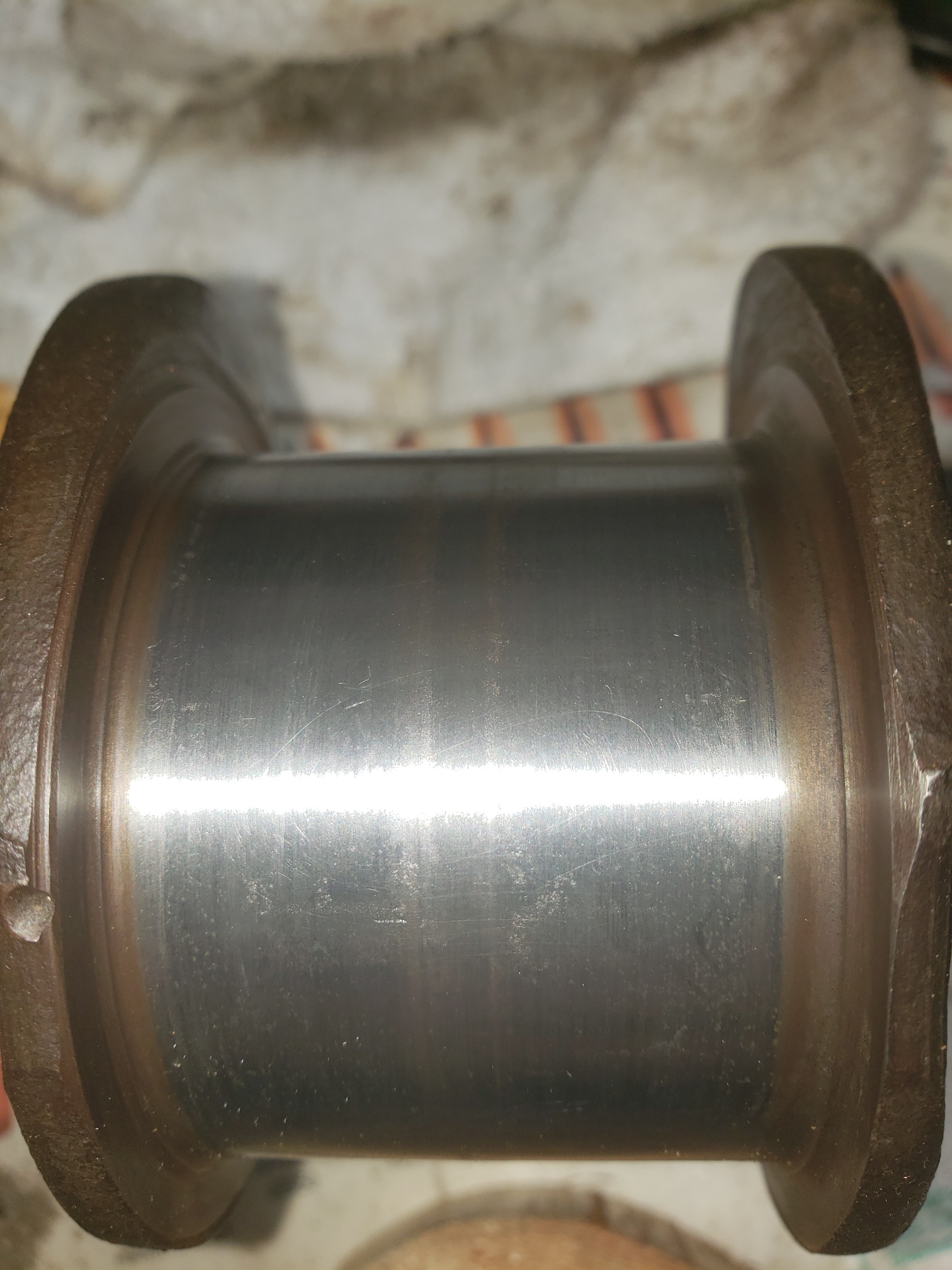

Post Options Post Options   Thanks (1) Thanks(1)   Quote Alex09(WI) Quote  Post ReplyReply Direct Link To This Post Posted: 22 Dec 2019 at 2:43pm
Your rod bearings shoudl be good to go with new .020 bearings. The mains you could keep at .020 BUT it all depends on what the wear is like on the journals now. If they are feel uneven with the end of your finger, they should be ground. I they are scored around the circumference of the jounal, they should also be ground. If they are nice and smooth then I would think you could put .020 bearings in and get the proper clearance with removing a shim or 2.
Some bearings are not stamped with the size, such as your mains, but your rods are .020 from the -SB20 suffix of the bearings. Other time bearings are inked with the size and the ink will come off from being in the engine.

Post Options Post Options   Thanks (0) Thanks(0)   Quote gman54313 Quote  Post ReplyReply Direct Link To This Post Posted: 22 Dec 2019 at 8:53pm
Alex,
thank you for your input the pic below is of my main all three look pretty much the same, If I remove a shim or two I believe I would have to file the bearing shell correct?

Post Options Post Options   Thanks (1) Thanks(1)   Quote Dick L Quote  Post ReplyReply Direct Link To This Post Posted: 23 Dec 2019 at 6:56am
The first picture at the link is where you check for end play. That is between the crankshaft timing gear and the side of the first main journal. The clearance here is a minimum of .0015. The gear is moved in to correct this space by the crankshaft grinder when grinding the crankshaft inside surface where the thrust shell rides.
