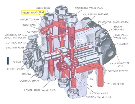

Just a conclusion....I pulled the pump all apart and tapped the relief valve seat back up to spec, reassembled, and it works fine.  I did have to back the screw out a little for lowering rate.  So far it picks up my rear blade (about 250 lbs) and my 280lb body on it with no problems.  So it was the relief valve depth although I don't know what pushed it down! Thanks for all your help guys!

I expect you are right about needing a return hose but everything I read online says just open the other port up on the rod side of the ram and it should be ok.  I'll call OK tractor today to verify that.  When I removed the pump I never checked the relief valve seat depth so  I wonder if it got pushed down and is not allowing the fluid to go back into the pump?  I'll check that as soon as i have time.  Here is a picture from the manual about what I am talking about.  I am also going to connect my original ram back up and see if it still works.  Probably should have done that before messing with the pump but never thought of it until this morning!

If the ball seat from the  top plug is pushed down too far the side port gets cut off.
