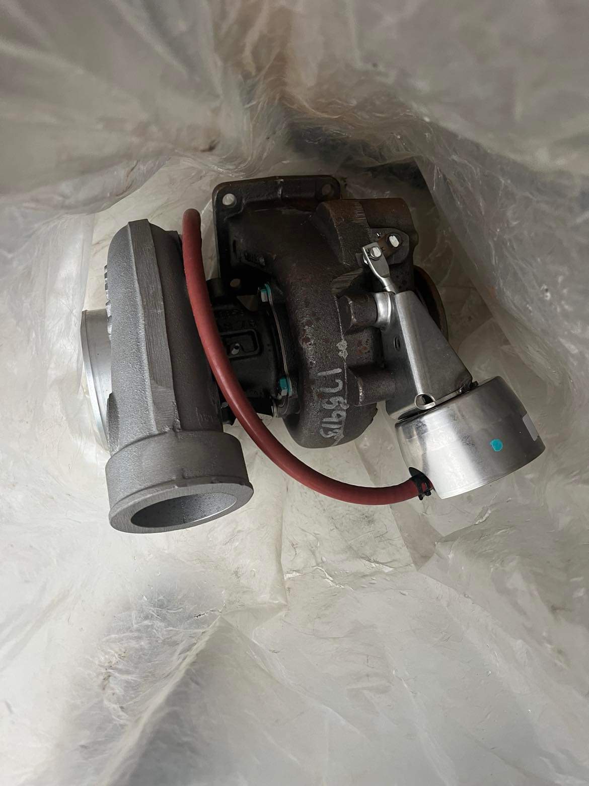

Post Options Post Options   Thanks (0) Thanks(0)   Quote JPG AUSTRALIA Quote  Post ReplyReply Direct Link To This Post Posted: 20 Oct 2024 at 5:19am
Picked up an s200 today of marketplace, bargain at $300 US. Pretty happy, as its brand new,guy bought the wrong one and wanted it gone.🙂
injpumpEd View Drop Down
Location: Walnut IL
Points: 5204
Post Options Post Options   Thanks (0) Thanks(0)   Quote injpumpEd Quote  Post ReplyReply Direct Link To This Post Posted: 20 Oct 2024 at 3:18pm
totally different S200 than I referred to, I'm referring to the S200SXE super core series. That one is wastegated, which probably isn't a bad thing if got it right lol.
