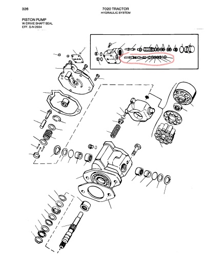

Mack,  Is that the flow compensating spool that is circled in red at the top of the diagram?

actually all three pumps are stacked (georotor,gear,piston)  The spool you have circled is for the stand by pressure (300-600psi) the other spool regulates demand (around 2300psi) need to check it also

The large front spool isn't the problem. It's either a false signal coming from the hydraulic valve stack, a stuck or damaged low pressure compensator spool, or the broken control piston inside the pump which sees to it the swash plate (which is spring loaded) cannot be de-stroked.
