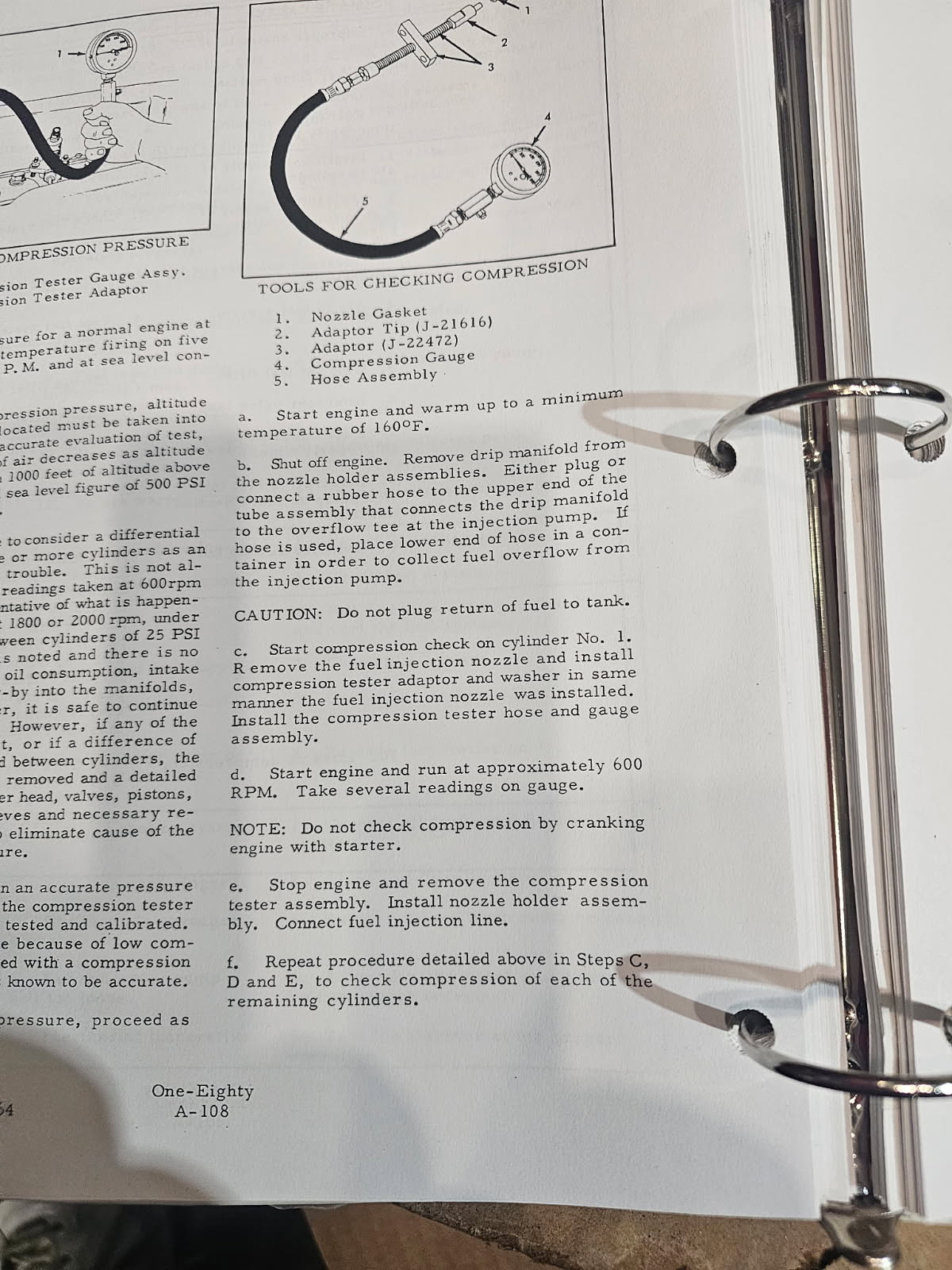

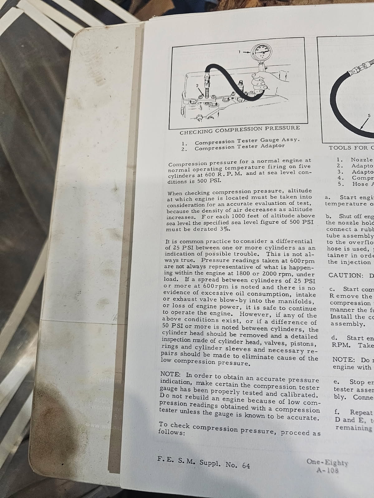

·         I measured compression after letting the tractor get up to a running temperature of 140F.  I then pulled #6 injector, installed compression tester and then restarted it running at idle (750-800 rpm).  This yielded a compression of 350 psi.
o   This above test matches what I found in a 185 Service Manual…it states under similar circumstances, a healthy psi is 500.  My 7020 Service Manual offers no criteria for a compression test.   I noted from the parts book that the piston from a 185 to a 7020 is a different part number so I don’t know if I can use the 185 spec.
