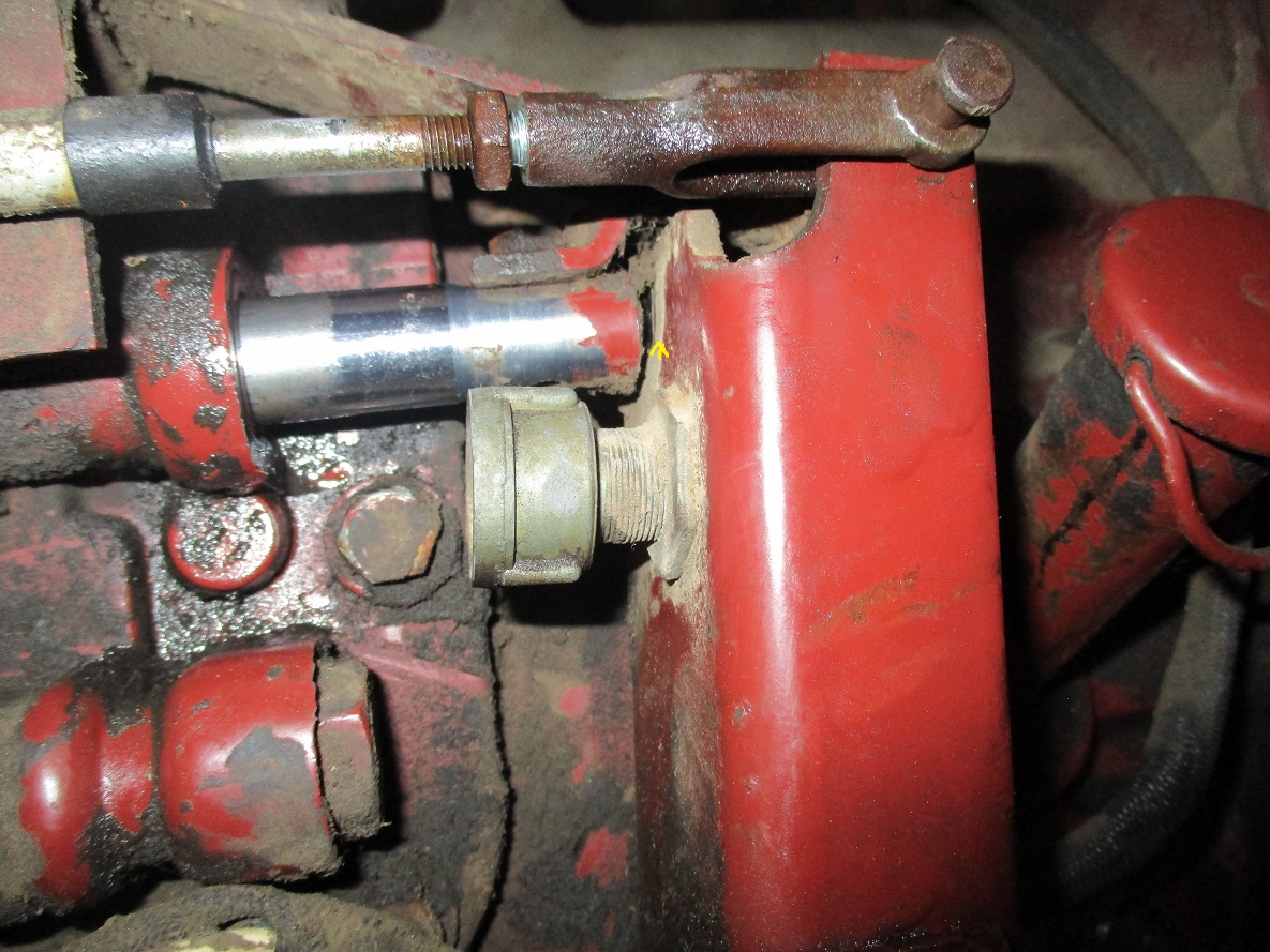

Make sure the cable goes smooth at lower end my be tight

I took the clevis off, and found the lever moves fine, no binding.  The cotter pin holding the clevis pin on has been changed, and was mangled. So I tried adjusting the cable some. Nothing changed. Still sounds like buzz saw cutting steel about 3/4 of the way, but quiet at the end. I hitched the 7000 to the mower, and found I would need shorten the drive shaft about 6". Then hitched the Zetor to the mower and found it comes 8" from the pto. I have not cut it yet. I need to do some measuring to make sure it will work on both tractors. In the picture by the little yellow mark. The plunger is supposed to have up to .020 clearance, not about 1/8". But it made no difference tightening up the clearance.

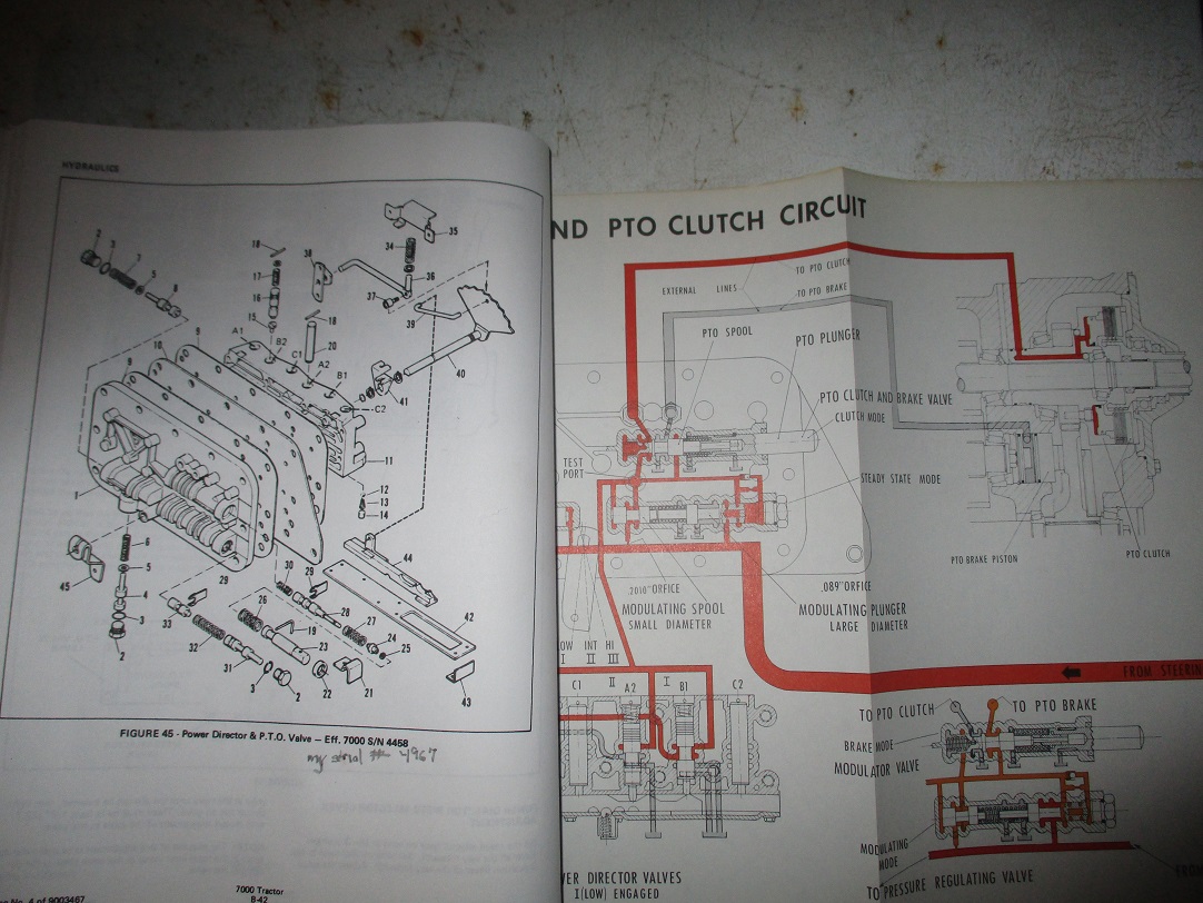

Thanks Tim for your reply. I do want to take the outer part of the valve body off. After looking in my manuals. Only a bunch of oil should come out, not other parts.
MACK View Drop Down
Joined: 17 Nov 2009
Points: 7664
Post Options Post Options   Thanks (0) Thanks(0)   Quote MACK Quote  Post ReplyReply Direct Link To This Post Posted: 19 Jul 2021 at 9:23pm
#29 and 33 will fall out. Make sure they go back in right places. They do crazy things if lost or in wrong places.                MACK
