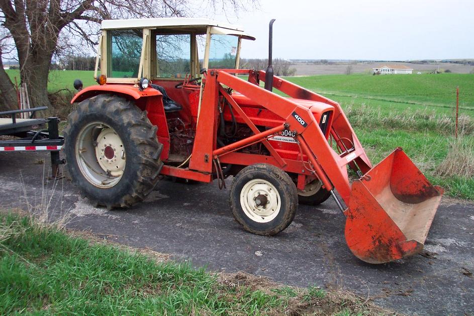

I had a 5040. It was a handy tractor.  Very fuel efficient.  40HP.  Good brakes.
The PS is great on them.
And if there's a loader or you plan on mounting one, it's definitely needed
The PTO uses the 1st stage of the 2-stage clutch; allowing travel stop while the PTO is still running.
Tin-work is substantial, but the front nose is fiberglass (or something similar) and is a bit delicate.....easy to crack.  Those are $$ to find/replace.
The one I had was a 6-speed. 3 gears in 2 ranges.  2 reverses.  Shift pattern like an Oliver.
Edited by Gatz in NE - 01 Oct 2017 at 5:02pm
