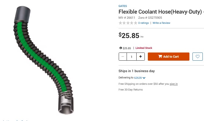

dont know what leg lengths you need, but you can use this GATES NUMBER at an Auto Parts store and cut to size..

Post Options Post Options   Thanks (0) Thanks(0)   Quote DougG Quote  Post ReplyReply Direct Link To This Post Posted: 13 Jul 2022 at 7:12pm
Thanks for looking but this one is short on both ends - like an inch on each end with a 90 % bend
Points: 89162
Post Options Post Options   Thanks (0) Thanks(0)   Quote steve(ill) Quote  Post ReplyReply Direct Link To This Post Posted: 13 Jul 2022 at 7:15pm
yea... i think the "original" part is no longer available... You will probably need to get a 90 degree bend like above and CUT TO LENGTH.
another, with only one bend... but 6 inches long

Post Options Post Options   Thanks (0) Thanks(0)   Quote DougG Quote  Post ReplyReply Direct Link To This Post Posted: 13 Jul 2022 at 7:39pm
Ok ok , gottcha Steve , the picture kinda thu me off - but yes this is what im looking for - aftermarket, and cut to length , thanks a bunch !!!!!
