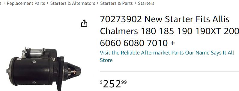

Post Options Post Options   Thanks (0) Thanks(0)   Quote DougG Quote  Post ReplyReply Direct Link To This Post Posted: 06 Aug 2023 at 12:36am
In my opinion- get a high torque starter, not the big heavy original,, thats what Ive been replacing mine as they go out

Post Options Post Options   Thanks (0) Thanks(0)   Quote Joe Goodwill Quote  Post ReplyReply Direct Link To This Post Posted: 06 Aug 2023 at 6:39am
Hey Doug, great idea where do you source these starters?

Points: 8436
Post Options Post Options   Thanks (0) Thanks(0)   Quote DougG Quote  Post ReplyReply Direct Link To This Post Posted: 06 Aug 2023 at 9:10am
Get them off Ebay; seen one listing but dang they doubled in price!
