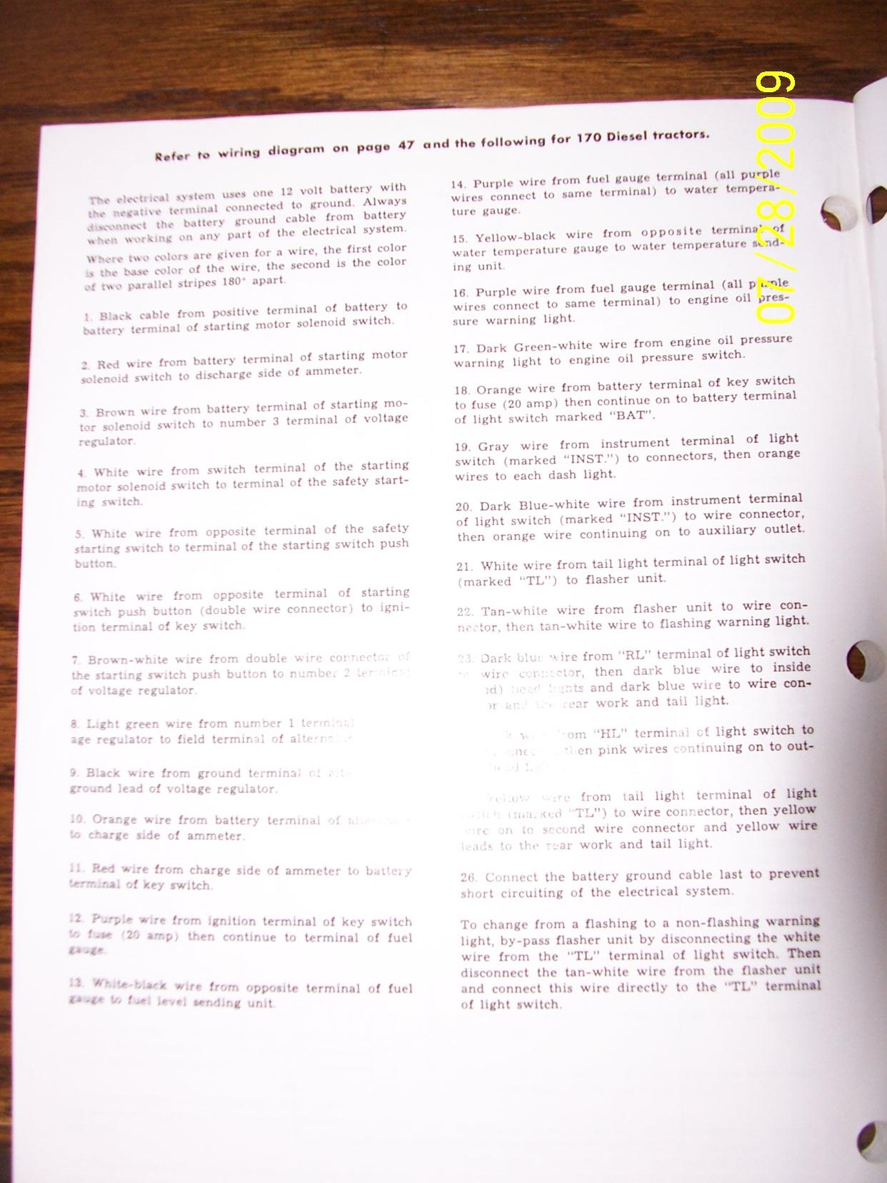

just a guess.... but the 170 diagram shows a BLUE wire going to the rear work lite and the TWO wires on the flasher are both an off white color...... 4 and 5 to the SAFETY start switch are also a white color..

Thanks for the reply. Steve, lines 5 and 6 are washed out in the photo. What wires do lines 5 and 6 describe?   Thanks again

yea... its a 20 year old photo i took with a camera of the book... FLASH did it.. I guess i took a second photo also... below.

Thank you. This helps a lot!. My recently purchased manual has the wiring diagram with just numbers on each wire but is missing the pages you photographed. Hopefully the 170 and 175 are wired the same. From the wire tracing I'd did on my 175 they appeare identical.   Thanks again.
