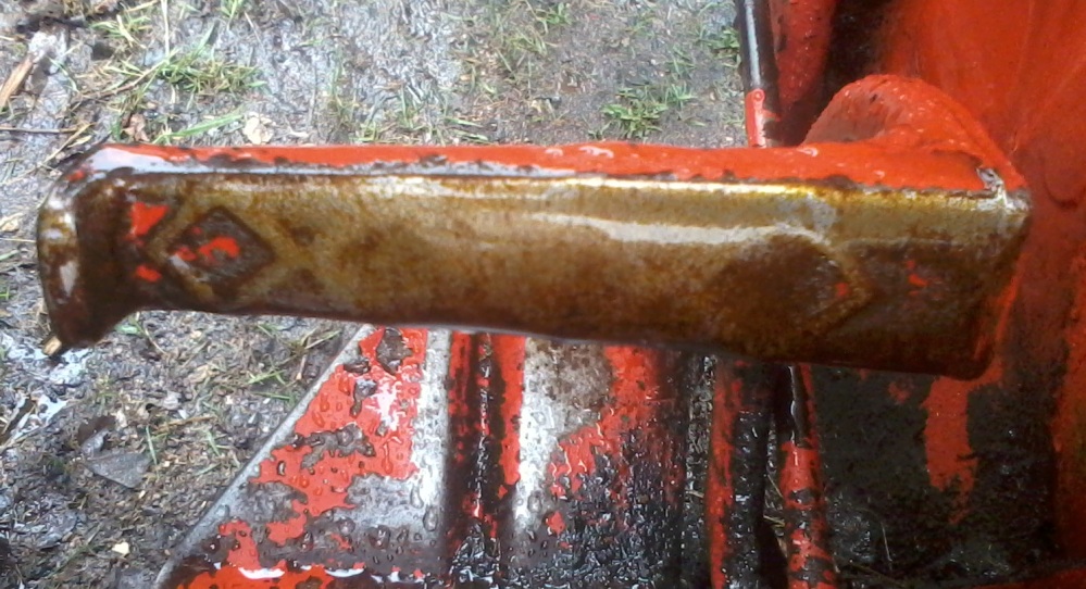

Alex, here is a picture of a clutch pedal on a 170 that has over 20,000 hours on it, and yes, it has a loader on it and gets started every day of the year practically... Definitely in the winter. It has been shifted untold number of times, maybe a half million times... an on the second clutch. ...  I have seen worse clutch and brake pedals that were worn smooth from side to side.
