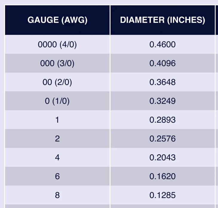

For 6v I use 2/0  fine wire copper welding cable
Points: 90645
Post Options Post Options   Thanks (0) Thanks(0)   Quote steve(ill) Quote  Post ReplyReply Direct Link To This Post Posted: 30 Dec 2024 at 4:43pm
Cables do make a big difference..  #1  is .065 square inches cross section.  00 has a  .1054 square inch cross section or 60% larger. ........... but im still not convinced thats your problem.. but would make a difference in current carry.

Got it.  Purchased a Deka battery and will hook it up tonight.  For all other wiring, is there a specification?  Previous owner has a variety of different gauges.  The shop manual didn't specify either.
Points: 90645
Post Options Post Options   Thanks (0) Thanks(0)   Quote steve(ill) Quote  Post ReplyReply Direct Link To This Post Posted: 30 Dec 2024 at 5:58pm
lights, ignition, distributor, coil.. etc... can all be 18 gauge.... Might use 16 guage to make it more BEFFY and rigid... Too much bigger and you cant get the wires into the switch box..
Generator wire to the amp guage should be 10 gague... and 10 gauge from amp to the battery.. 10 gague is good for about 30 amps... more than the generator can put out.

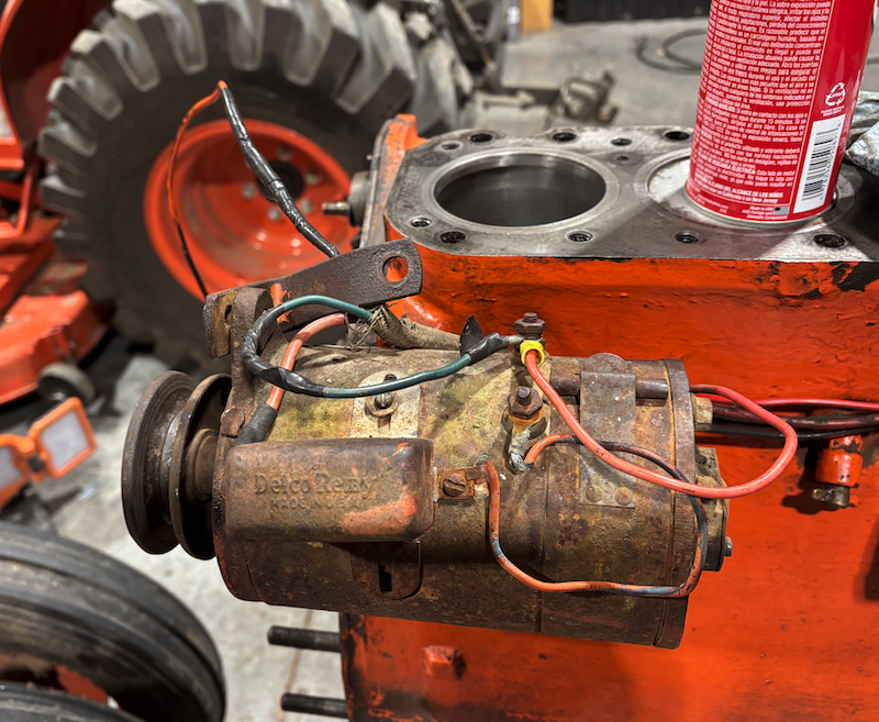

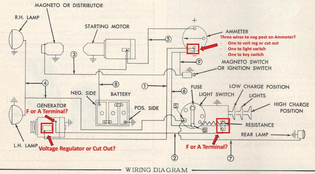

So the weather has been cold in Delaware and I don't have heat in the pole barn.  I know whaaaahhhh, and holding tools was like holding ice cubes.  In the meantime, I went ahead and bought a rebuild kit for the carb.  Then while rebuilding, I broke one of the small parts so I'm waiting for a replacement.
As far as wiring is concerned, PO had the tractor wired for a negative ground.  I am in the process of switching it back.  Also when I inspected the wires, most of them were worn down and exposed.  So I figured I would re-wire everything.
After consulting this thread, I have purchased the appropriate gauge wires ring terminals, and I'm ready to run wires.  I'll post photos of the mess the previous owner had for context.
Now for the questions:
Using the diagram, there is a wire that goes from the light switch to the generator.  Does it go to the F or A terminal?
Using the photo I posted, do I have a voltage regulator or cut out?
Using the diagram, there are three wires that appear to go to the negative post on the ammeter, but I want to confirm.  One wire from the key switch, one to the voltage regulator or cut out and one to the light switch.  Is that correct?
Edited by pudi211 - 29 Jan 2025 at 6:36pm

Looking at the above photo I posted, you can see the previous owner had a wire going to the voltage regulator or cut out (still not sure what I have).  He then had a jumper going to the A terminal and he had two wires going to the F terminal. None of this lined up with the wiring diagram, so I wanted to get an answer from someone here before I start cutting, crimping and heat shrinking.
Head and front end are back on BTW.  I also bench tested the generator and that is not producing voltage.  Planning to rebuild that, but I want to see this thing run.
Thanks!
