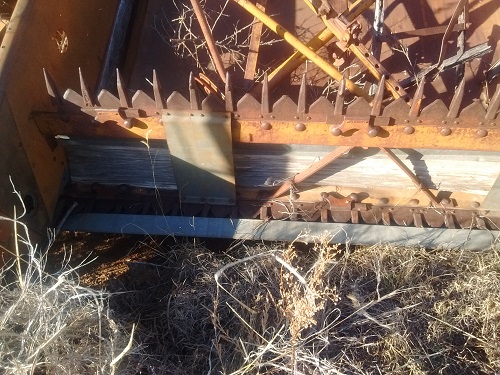

Does anyone have a photo of a bundle topper attachment installed on an All-Crop, so I can see what it looks like? I have one, but I don't think it's complete. I have the bar, sickle, and guards, as well as the brackets that attach to the combine cutter bar.

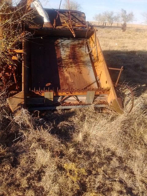

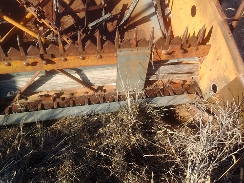

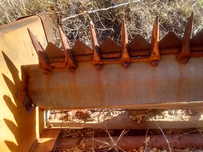

here ya go Creston
if ya wanna PM a cell #,I can text a couple more, and they will be original size an you can save em however ya like

How does that contraption work?

After the binder does it's thing, ya take the combine to the 'shocks', lay the heads on the cutters,(the top sickle) the butts are tossed aside, but gathered for cow feed later

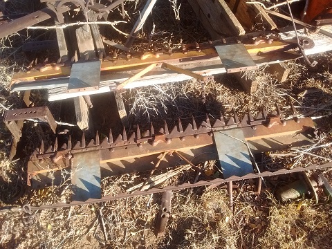

The upside down V thing bolts to the cutter bar, to hold it up. Those 2 wide metal pieces bolt to the bottom sickle. When you run the combine, the bottom sickle drives the top one then.

So it's like bringing the threshing machine to the bundles instead of bringing the bundles to the threshing machine?

I imagine a guy wouldn't want to loose his balance around that thing huh?  True of most any combine, or impilment, but that would be a bad day

yeah....where's the safety shields?

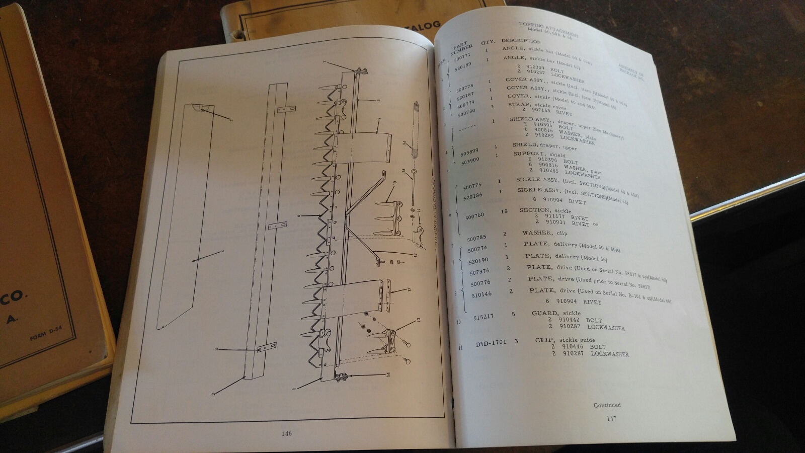

Here are some pics of the one for a 60 and a 40. Below them are pics from the 60 Hook of the topping attachment, a tach for cylinder speed, and a wagon loader for straw.
