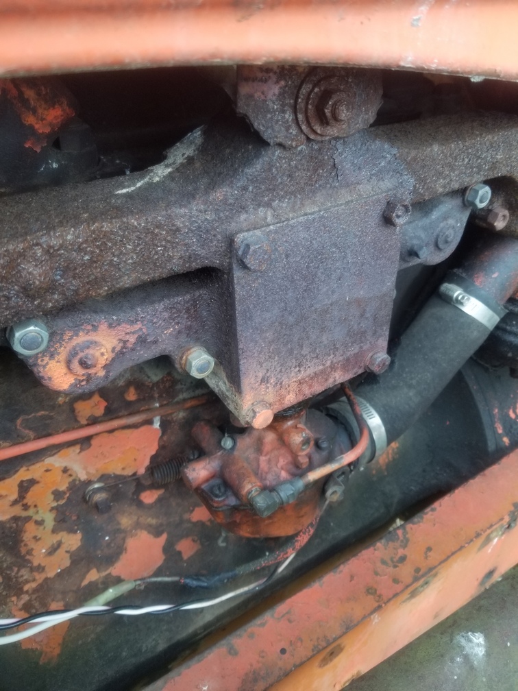

So I've got 2 numbers on the block first in 45-2519-G and the second is mostly illegible but starts with AM
This is a photo of the manifold in question.

The engine serial number should be 45-xxxxxx-K. The block itself isn’t different but if you going to the trouble to put together a 45 kerosene tractor the value won’t be as much to a collector if its not correct. The carburetor number is tsx 561. Im going from memory on that but i think its right. There were two low compression pistons, the one mentioned by dr allis and I believe oparts book shows a 5.0 compression piston as well. The manifold pictured is a gas manifold. All kerosene manifolds had the exhaust on the bottom and a 45 kerosene manifold will be virtually impossible to find. A wd kerosene manifold wont work as the air breather is bigger and will hit it. The 45 K manifold has a 45 degree bevel on the #4 cylinder. It should have shutters. Post the tractor serial number and i can check it against my registry of kerosene 45’s. Pm me your email address and ill send you pictures of what it should look like. Michael

I've got a WD45 owners manual. It shows a different manifold than that (still up thru the hood) and on another page shows the side outlet more like a WC would have had. It does say specifically the engine compression ratio codes for a WD were FK for kerosene and FG for gasoline which are stamped at the end of the serial number. The WD45 engine s/n should read 45-XXXXX-G or K.   Nebraska Tests #499 and #511 were 45-3600-G and 45-5449-K for example.
