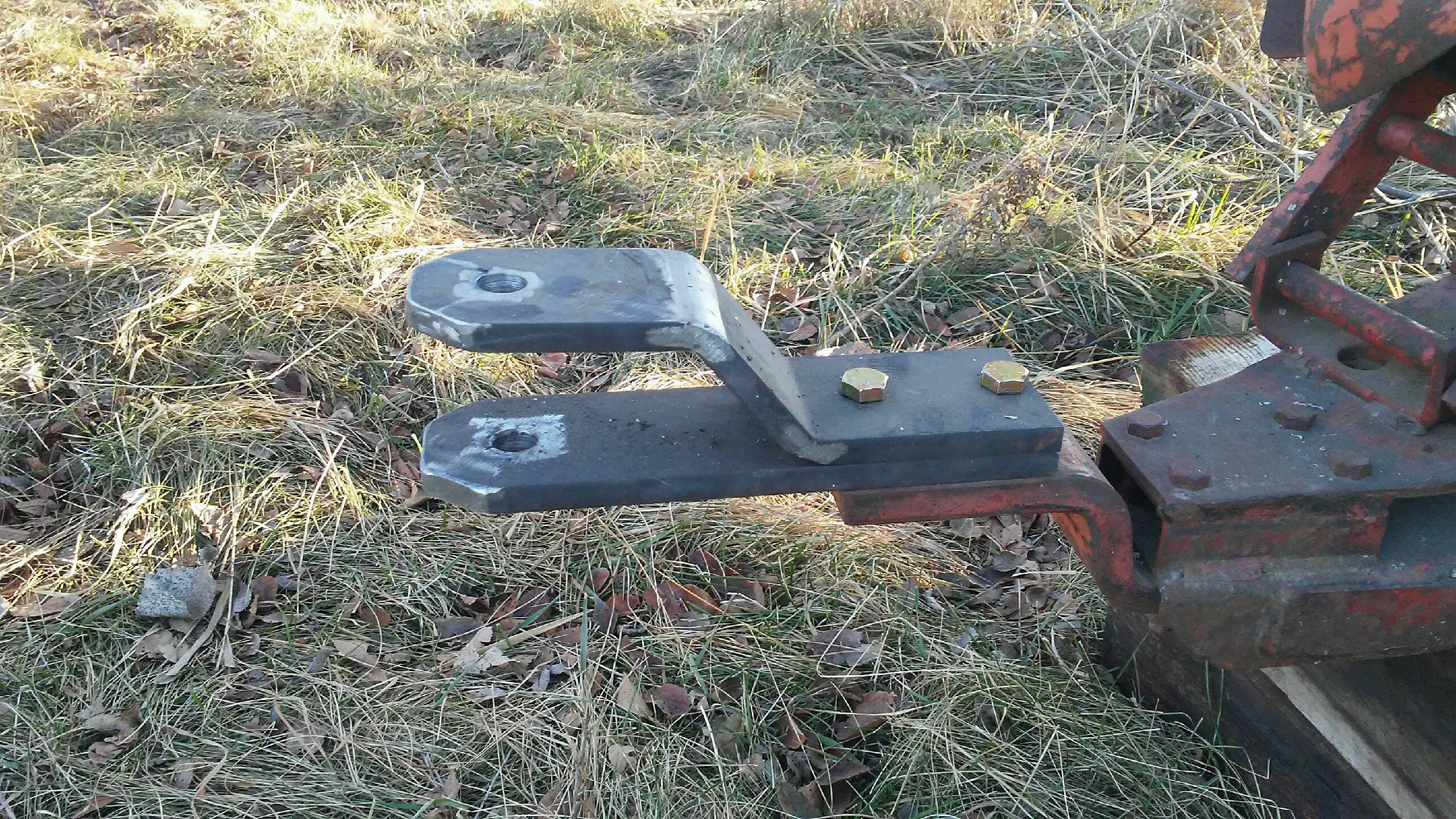

Post Options Post Options   Thanks (0) Thanks(0)   Quote truckerfarmer Quote  Post ReplyReply Direct Link To This Post Posted: 25 Nov 2017 at 11:30pm
Ended up making a pin hitch. Put it on this way to line up with hitch on truck.

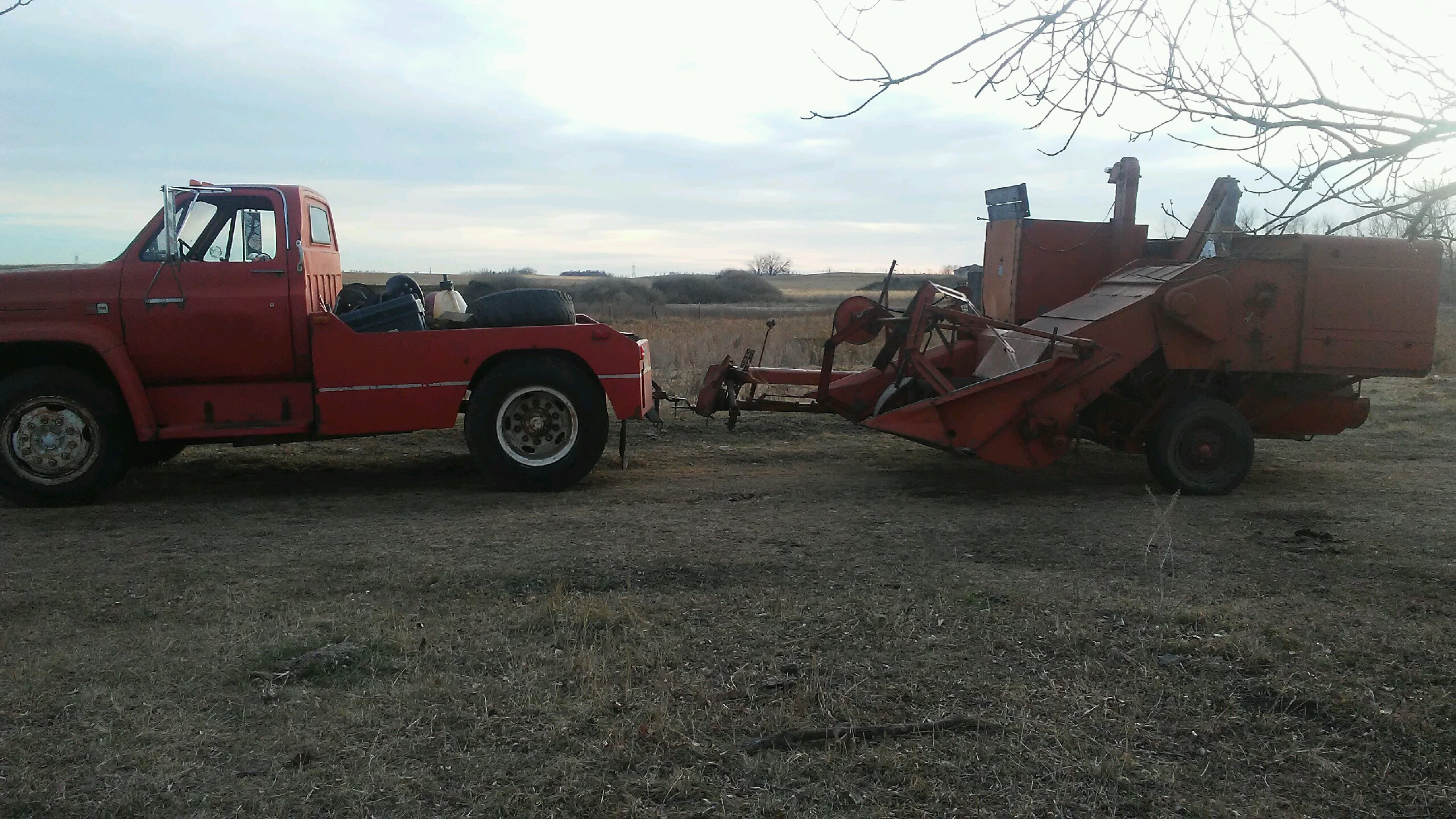

Here's the 72 home at last. Gotta put a couple tires on the 90, then it will make the trip home.

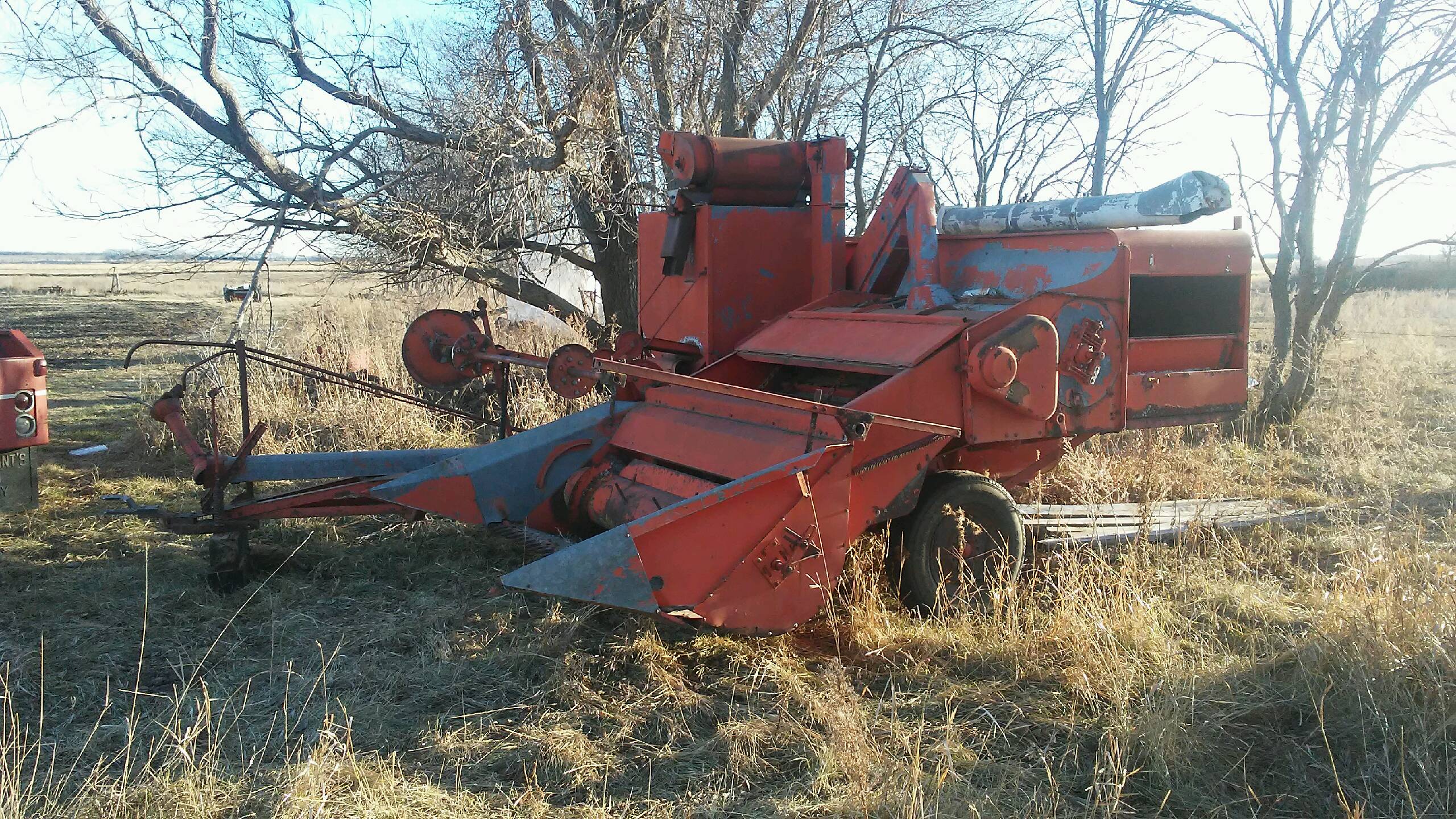

Got the 90 home today.
