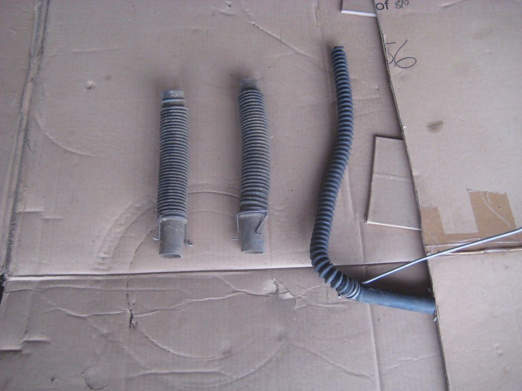

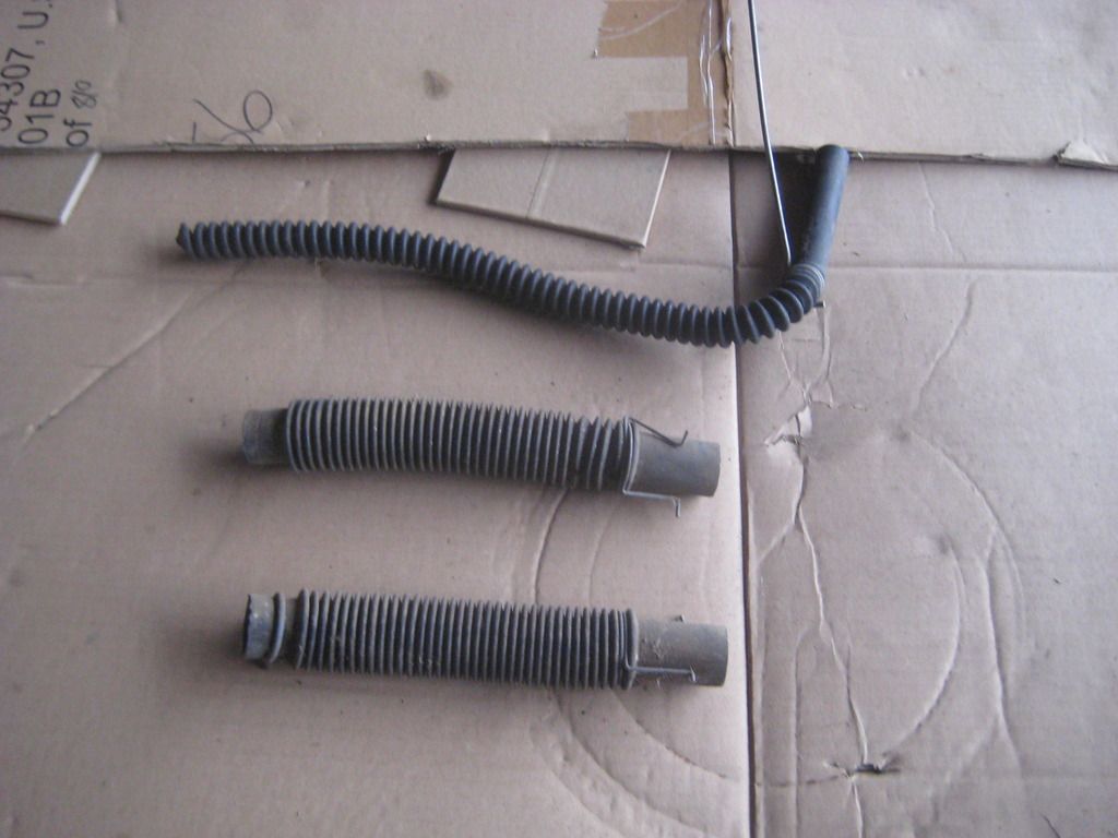

I could maybe get a picture of one of the original smaller tubes, as I have one left on the drill I'm working on. I'll work on that picture later today. Maybe have one of the larger ones too. Need all of the remaining ones, though as Rick does. Dave

Post Options Post Options   Thanks (0) Thanks(0)   Quote Dave (NE) Quote  Post ReplyReply Direct Link To This Post Posted: 23 Nov 2016 at 12:11pm
Here are a couple pictures of the "surviving" original tubes I got with the snap couple drill I acquired a couple months ago. Hope this helps to identify where new/similar ones can be obtained or if anyone has some of these in their stock. It takes 22 of the larger ones to be complete and 11 of the smaller ones. And Rick, sorry, I didn't mean to still your post, but as I'm also looking for these tubes thought I'd join in on the discussion. Tkx, Dave

Post Options Post Options   Thanks (0) Thanks(0)   Quote Rick143 Quote  Post ReplyReply Direct Link To This Post Posted: 23 Nov 2016 at 6:47pm
Those hoses look the same as mine.
