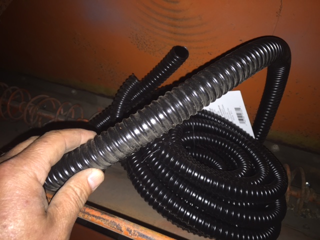

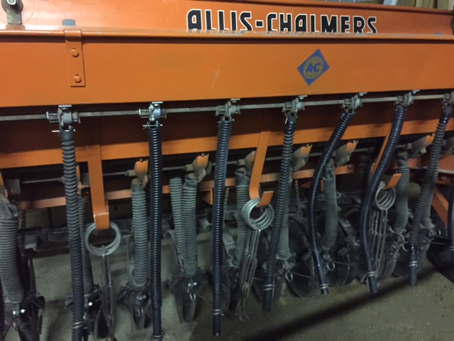

Last fall there was a discussion thread regarding the grain/fert and grass seed tubes for an All-Crop Drill. I believe there's some workable options for the grain/fert tubes through AGCO, Great Plains etc, but I had never found anything suitable for the grass seed tubes, which are much narrower. I stumbled across an option this summer and thought I would share. While strolling through my local Menards store, I saw some narrow, flexible, corrugated, black tubing called "Pond Tubing". There are a couple of different sizes available but I found the 3/4" most suitable. At the bottom, I glued in some narrow PVC pipe with adhesive caulking, and secured with small cotter pins. Then I spray painted the PVC with matte black paint. The narrow ends fit nicely through the spiraled holders.
On the drill pic, the tube on the left is an original, the next two are my reproductions, then another original, two reproductions, and an original.

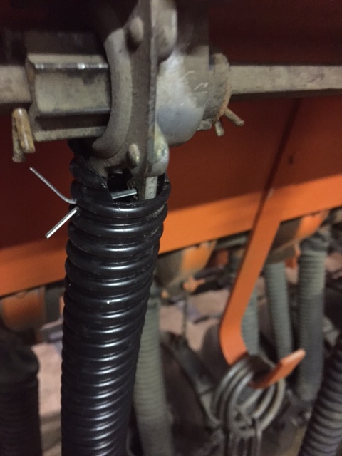

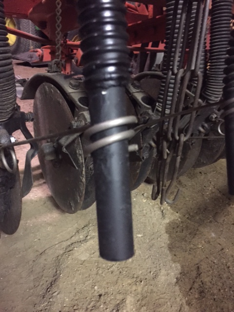

Post Options Post Options   Thanks (0) Thanks(0)   Quote Kyle(MN) Quote  Post ReplyReply Direct Link To This Post Posted: 13 Sep 2017 at 10:51pm
Here are pics of the bottom and top- can't really see the cotter pin at the bottom as its painted black.
It seems to me I tried to find the spring holders in the past, with no luck via Agco. I started to make a few, with OK results, using stock steel rods that were a slightly narrower gauge, and then bending in the spirals. I was able to find a parts 11x7 this summer and that had the tube holders that I was able to use.

Post Options Post Options   Thanks (0) Thanks(0)   Quote Cernunnos Quote  Post ReplyReply Direct Link To This Post Posted: 14 Sep 2017 at 5:09pm
Thanks for the closeups Kyle.  That helps a lot with my CA grain drill project
