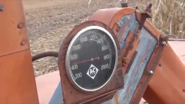

I saw this on a Youtube video on an All Crop 66, I'm assuming this is a tach for the cylinder speed? Were these common? Guess i've just never seen one before. Where/How did it attach to the cylinder?

They are for cylinder speed yes, are they common, no.  I would say they are borderline rare.  I am not near ours, to be able to say for sure where they connect to, but I think it is on the rotor shaft at the drive belt connection.

Just about all of the combines I've owned ether had one on or showed signs of one being on.
The cable attached to a special nut on the end of the cylinder. I will add a picture to this post later.

First is of the special nut with the cable attached. The nut is threaded directly on the cylinder shaft.
