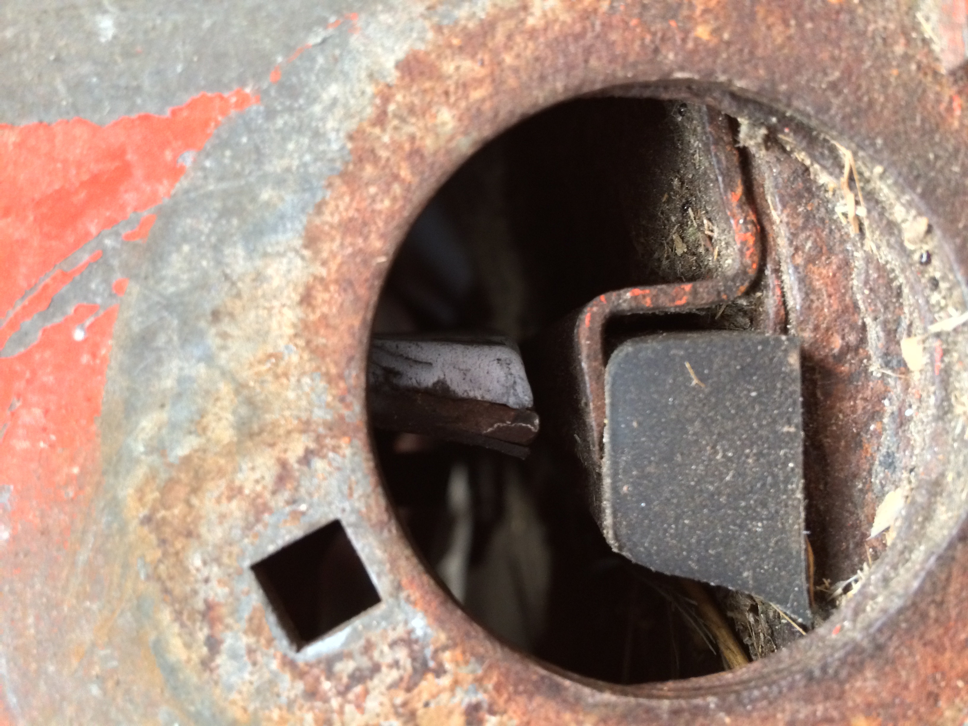

Good day,
I have a 72 all crop combine.  I replaced the rubber shelling plate and rubber concaves last year, but now I'm trying to decide whether it is time to replace the cylinder bars due to rubber wear.  Wheat comes out pretty clean, but I found I was cracking white beans a lot last year.  I guess the rubber on the bars should be square and flush with the metal face of the angle iron it is attached to?
Also, I know about the terrific all crop parts guy in PA, but I'm wondering if anyone rebuilds the bars (ie:  replaces the rubber on the original bars).  I doubt this, but thought I'd ask just in case.
Look forward to hearing from anyone with experience in this area

Update to my original post:  I am trying to get a good photo of the tip of cylinder bar as it passes by concave bar (as seen through inspection window on side of machine).
That is what mine look like, they must just clamp in there.
Good day,
regards
Welcome to the forum!
In regards to your beans, I've always been told speed cracks, clearance crushes. I'd say you're running too fast, as your bar looks pretty good yet to me.
On small hard grains, you don't even need the rubber (hence the reason all other brands of combines had steel rasp bars). All 3 of my All-Crops have the rubber worn down to practically nothing (some bars have the rubber totally gone), and do excellent jobs in wheat and sorghum, but I would imagine having good rubber would be important for white beans, but then again, I've never combined any.
You are correct when you say the rubber should be square with the end of the angle iron (at least, when new). The rubber was originally vulcanized (to make it wear longer) and on the first year or two of All-Crop production they were riveted to the angle iron, with subsequent years using what I guess was a special adhesive. I've heard you can use automotive adhesive to glue new rubber on, but I've never tried.
There is a place out of Wisconsin that sells new bars but I can't recall their name.
Your replaced concave bar looks good. They are somewhat easier to replace, being as they are just clamped down.
Edited by CrestonM - 09 Feb 2019 at 11:07pm
Good day,
regards
I took over selling those bars from the Wisconsin fella...
BTW that rubber looks good in the pic.
