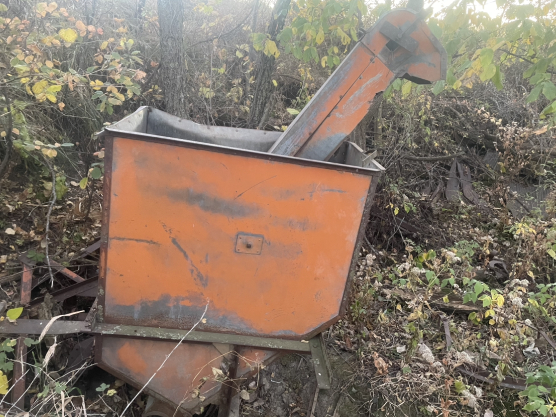

So I’m running a grain cart for my brothers and sure enough I found another possible all crop in a creek.
Reason I say possible all crop is because im thinking it’s the older style round back….
Will get pictures as so as I can but getting too dark now.

The second picture is the rest of the first one I found…

Post Options Post Options   Thanks (0) Thanks(0)   Quote wjohn Quote  Post ReplyReply Direct Link To This Post Posted: 22 Oct 2024 at 7:35pm
Yep, that looks like two of the earlier combines. Someone must have really hated them or they survived a tornado.
If there is a perforated sieve/screen, it will be basically at the bottom of the RH rear stack of racks at the rear of the combine. Stand outside looking down the straw rack (sideways/across the combine) and then go down to the bottom of all the racks/trays. There may be a removable one at the very bottom - or there may not. They are commonly removed  or some crops like oats didn't require an additional screen.
I wonder if the screens are the same size as used in the later All-Crop 60, 66, and 72?

I have an odd request...would you be able to get the serial off this combine? It's in front of the grain bin stamped on top of the angle iron frame. There aren't many of these 1935-1937 All-Crop Harvesters left, and I haven't seen a 1935 model to date, and only two 1936 machines. Several 1937s, however. Very cool that you have two of them there, even if the condition is poor.
