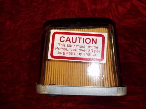

New Diesel Fuel Filter Fits John Deere 2030 2040 1520
some John Deere used glass filter
