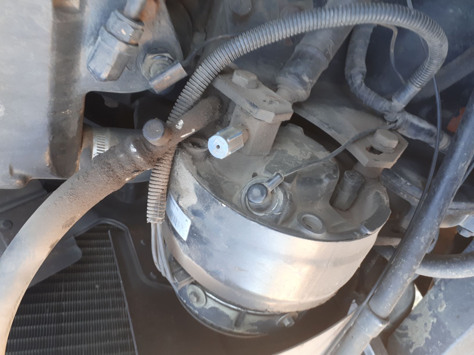

Thanks for the help.  I only see a blue cap and a small black cap.   Here is a picture of my compressor.

can you unscrew the cap? those caps are kind of generic for 134/12

They had R12 when new. That one has R134 in it. The high side hose obviously is leaking at the crimp and those pancake compressors weren't very good especially with the R134 gas.

Looks to me like a complete retrofit,, get ready to spend about $1000.00+ or-,,,a new 134 system will work fine..update to a Sandon compressor, new expansion valve...etc...
