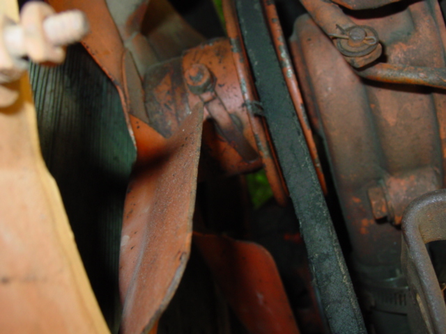

Having clutch and pressure plate and torque tube laying around was the last deal. This after noon I started mowing the front yard when the fan belt started to smoke and then spit out the side. The generator seized up. I found an old narrow belt about the correct size and after looking around I found a generator with a narrow pulley. I sprayed the adjustable fan belt pulley with WD40 and went in to eat supper. I came out and loosened the two nuts, took a large blunt screw driver and after a few whacks with a large hammer it tracked back tight in the center. I had to place 3/4" of washers behind and find a longer bolt to make the belt tightener work. Took the old girl out a 9 PM and mowed the rest of the front lawn.

I'll start with the last first. The adjustable water pump pulley that some have problems with. As I stated before I take them apart when rusted together with heat and tapping with a hammer as I apply heat. I then sand until I can slide them in and out before assembly. You can see by the picture where it moved from.
The old belt is a little long and most likely will not last the summer.

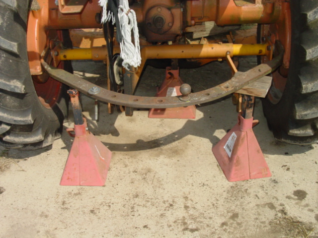

This is how I stabilize the tractor when splitting it. I have it off the ground on the jack stands.

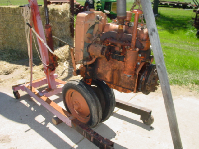

I use the engine lift to pull the engine away.

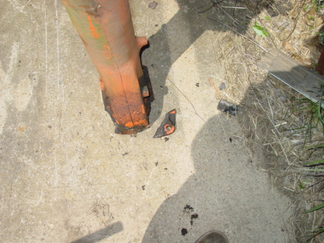

The sheared cotter key.
Where the drive shaft splines were stripped.
The drive shaft I used as a replacement.
Replaced the cotter key with a grade eight bolt.
